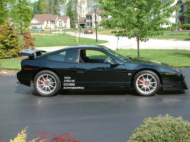

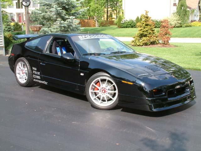

that is the size of my rims and on them i have 215/45/17 and 245/45/17. I like the look of a slight rake with the tire a lil bigger on the rear.. just my tastes..

yes there 17x7 all the way around. I like the look of a lil taller tire in the rear. It handles ok but the suspension needs tweaked some, an area that I've not touched "yet". There is very lil play in the tires from side to side due to the the fact that they are the highest speed rating you can get.If it had better struts like say Konis it would be great. It also need poly everywhere in the rear. I'm planning on going with coilovers all the way around when i start on the suspension work and i'm told that a 275 series will fit with the room made by the switch. I'm running 285's on my S-10 and there HUGE, So that is what i'm shooting for on the GT 275's on about a 10" rim. (much more research needed to see if this combo will work). If anyone is running something like it on an 88 please let me know.

they prefer that it go on an 8" rim. but if you play with your tire pressures you should get even ware, and i've put mine through some tight corners at speeds over 105mph and they handle ok. besides tread width on a 245 is 7.5" so if you have room you should be fine. just get the highest speed rating as you can afford. the higher the speed rating the less side to side movement you will get. mine don't move 1/4" if that. speed rating Y-186mph
