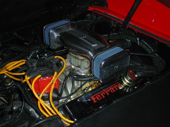

Here's what I did:
It is a 600 CFM Holley on a Holley Street Dominator intake with a thick (3/8"?) base gasket and a 10" Holley air filter. It fits under the hood with about an inch to spare. The engine is in the lower mounting holes on the front plate. I have a Cadillac top hat that I was going to connect to the factory air filter, but it looks to be too tall.
