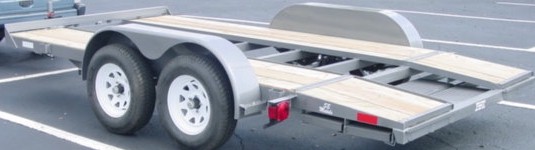

I used to use a 99 Jeep Cherokee with an open trailer. It had the power, 4.0 6 cyl, but being a short wheel base, the towing ride would get downright scary at times.
The Pathfinder is about the same size/weight.
The weight of the car is around 2800, the trailer was 1400 lbs. That's about 4200, most short wheel base truck/SUV's would handle that.
The U-Haul trailers are about 2100 lbs empty !! That would put you close to the 5000 lbs limit.
A tow dolly might be an idea, it's alot easier to pull, as the load is on the ground & and not hanging off the rear bumper.

CoolBlue87GT
Posts: 8521
Total ratings: 150
Report this Post11-02-2003 03:11 PM Click Here to See the Profile for CoolBlue87GTSend a Private Message to CoolBlue87GTDirect Link to This Post
Originally posted by Raydar:
CoolBlue,
Was your trailer a tandem axle or single axle?
Tandem with electric brakes.
The good thing about the flatbed as compared to the dolly is that the flatbed probably has automatic hydraulic brakes, activated by deceleration pressure on the hitch. A dolly won't have brakes at all.
The U-hauls use those automatic hydraulic brakes. They would give you an little "thump" while slowing down. It always felt as if someone hit the trailer from behind. If you rent one now & then, their fine.
If you buy a trailer, electric brakes are the way to go. You'll need a brake controller box intalled inside the truck.
Here's my current trailer.
