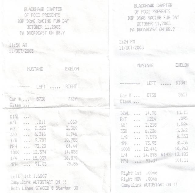

some of you may have followed my 96 3.4 dohc w/automatic swap into my 88 gt. well today i put it to the test to see what it would do. i had the unbelivable chance today to run side by side with a imaculate stone stock 88gt w/auto to use as a comparison, he was running consistant 16.8s in the quarter and my run with him i did a 15.0. my cars best for the day was the last run during eliminations where it did a 14.89.
as you can see by my 2.2 60 foot times that my car is not a blaze of fire out of the hole. i have yet to hear the tires squeek on dry pavment. i think with my setup i am in dire need for a looser torque converter,the stock one is just to tight. the engines bottom end is a little soft but when it hits 3500rpm the exhaust gets loud and it suddenly takes on a different attitude and starts pulling hard all the way to the 6300 rpm shift point. it almost feels like a nox charge is hitting the engine. i also brought my stock 99 gtp w/3800sc engine to run a few times and it was running almost identical times as the fiero was. anyways wow! that was fun
