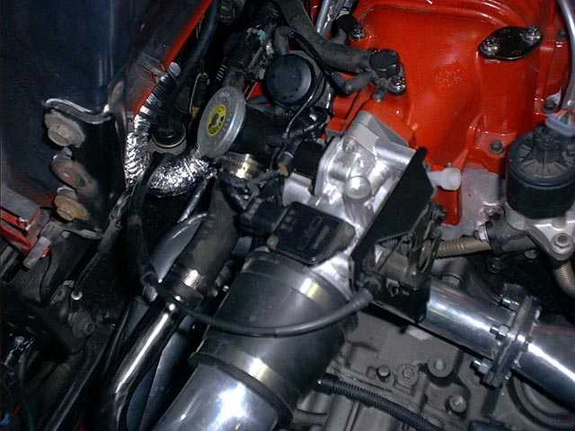

now is that a nice clean install
Check out the nice tubing.

Nice work man. Where did you get that intake? And how much?

And, btw, where did you happen onto that intake piping there? I like the looks of it!

Cool looks really nice! How did you relocate your alternator if I may ask?

I used the Fiero alternator bracket and used the 97 GTP dogbone bracket and had them welded together.

Intake was from a 88-91 honda CRX. I got it off Ebay for 30.00 with cheap filter. I used a 3" rubber tube from the tb to tube and got it from home depot.

I tried that intake...... trust me when I say "your gonna hate it"
Try a stock intake or something, when I tried that intake it, for some reason, restricted the intake so much that it bogged on take off. In fact I've tried four differnt types of intakes and that one was the worst as far as restriction. I thought it would've been the best, but the differnce in performance was unbelievable. It did sound nice though, it amplifies the whine a bit.
