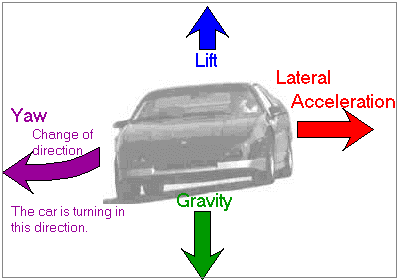

Look at the configuration of the 84-87 rear suspension. The toe links are behind the control arms. When the car is sitting level, the toe link is nearly parallel to the ground. If you enter a turn and start to slide, the natural reaction is to get off the gas and/or stab the brakes. If you do that, it extends the rear suspension. When the rear suspension extends, it shortens the horizontal distance between the steering knuckle and the toe link locating bracket on the frame. This causes the rear wheel to toe out (seems like I read that this can be several degrees). Add that to the fact that the rear is already "light" due to the deceleration of the car, and already wanting to spin due to the forces of inertia.
The redesign of the 88 suspension removed most of this tendancy. In full compression or extension, the toe doesn't change much at all.
One of the specialty suspension vendors (Held or RCC) had a much better explanation. Probably on the same page as their bump-steer kit.
This is the "short" version. As I understand it, anyway. (If anyone sees any glaring errors, please feel free to correct me.)

I just wanted to chime in again because I like sharing my delight in the way my fiero feels when cranking around a curve.
In addition to the outstanding information above about the mechanical parts of the fiero and the basics of how the rubber meets the road. There is another aspect to the fiero (and other cars) that one must have a basic understanding in order to appriciate a cars ability through chance or design.
The physics involved in getting a car to turn a corner are as complex as a shuttle launch and setting a car up to do it well can cost as much in research and development. At the center of this canundrum is what I will describe as "energy management and dynamics". In short it is the way energy (weight)is transfered around the car and ultimatly to the ground.
To start with, the fieros balance point is very close to the drivers head (inner ear)when seated with the seat all the way back and slightly reclined. To further enhance this sense of balance is put both hands on the wheel, snug the seatbelt up and sit squarely and firmly in the seat.
A typical front engine cars balance point is typicaly somewhere between your knees and kiester and if you never noticed, every seat is reclined slightly putting your head even further from the fulcrium. NASCAR drivers sit very close to the steering wheel for this reason, it also reduces arm fatigue on those gruleing 500 milers but as any driver will attest, having a good "feel" for the car is crutial and putting ones inner ear as close to the CG is all the better.
Having a feel of how much and how fast energy is disapated when cornering is important. Particularly with a fieros propensity to sling it's rear end out when the tires get unloaded due to a forward weight shift as (speed) energy gets scrubbed off.
Having more power does help in a fiero but only to a point. Compared to a corvette in the same condition requires a bit more finess in order to get weight to the rear without agrivating the situation by overpowering the rear wheels even more. Yes, one can easily get both cars in a heap quick but basicly a corvette requires a totaly different energy management strategy.
If you can get a fiero to stay door handle to door handle with a corvette in a straight line, you will smoke him off the track in the corners. Having weight on the rear has it's pluses and minuses but the pluses are far more in number.
Is a fiero "dangerous" in a corner going fast? Absafrigginlootly yes if you are an unweary novice but then again any car is dangerous if you do not know what it will do and how it will react.
A fiero will not fishtail agressively like a front engine car can If anything a fieros rear will come back without any steering correction at all and do it slow and steady as long as you dont let off the gas and upset the front/rear balance. To me that is a major plus, I like keeping my foot on the gas.
