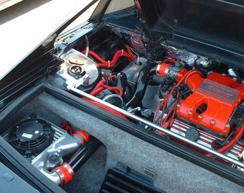

3800 Series II L67 shortblock -- stock
3800 Series II L36 heads -- mildly ported
3800 Series II L36 Camaro intake
Stock cams, rockers, springs, etc. Stock 87 Buick Grand National turbocharger running 10 lbs of boost on 93 octane fuel and 15 psi on 105 race gas additive (Klotz Hitrate). Stock 91 Dodge Spirit R/T intercooler (for now). This car is setup for street/strip duty and is beat on daily. In fact, I have put over 6,000 miles on this current combo in the last 2 months. Using a 95 4T60-E from a bonneville with a stock rebuild, the only mods include modified 1-2, and 2-3 accumulators, and an adjustible modulator.
BTW, I have less than $3000 invested in the car as it sits including buying the car. Pics can be found at http://dtcc.cz28.com/87fiero/index.htm
Drivability? Excellent, very little turbo lag, very quiet especially on the highway you can't even hear the engine over the road noise. Almost like that turbo was made for a 3800. Ran a 13.4 @ 103 in the 1/4 untuned on a hot day on pump gas. Recently raced a friend's cutlass that turned a 12.9 and beat him by 2 cars so I know it will definately run 12s. (just haven't had a chance to get to the track)
I can tell you that it needs a bigger intercooler so I am in the process of rectifing that situation now. Should allow me to run 13 or 14lbs of boost on pump gas.

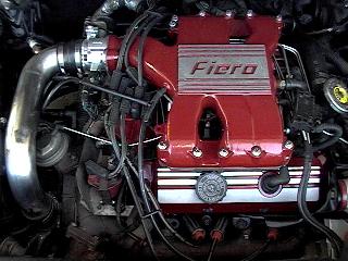

Well, you've all seen the specs on mine in the For Sale forum, but here it goes anyway:
Engine
Type: Pontiac Fiero 60* V6
Crankshaft: General Motors 3.1L V6
Pistons: JE Custom Forged Aluminum
Camshaft: Crane Compu-Cam 2030, valve springs, and lifters
Cylinder Heads: Stock ported and polished, Valve job - full radius, hand lapped and blended
Compression Ratio: 8.57:1
Induction: K&N filter, port matched runners, Stage 1 turbo kit from Fiero Conversions in Windsor, Ont. Canada
Ignition: Accel SuperCoil, MSD 6 BTM box, Accel 8.8 Spiral Core wires, AC R41-TS Spark Plugs, Cloyes True Roller Timing set
Exhaust: Port matched manifolds, Custom 2 1/2" mandral-bent exhaust system , Supertrapp Stainless Steel 4A Muffer
Calibration: Stock engine control module with custom PROM for turbo
Transmission: Stock TH125-C 3 speed Automatic Transmission with performance shift kit and valve bodies.
Cost? Much more than I want for the car itself.
Thoughts? It's nice. Provides a subtle little boost (no pun intended) in acceleration. It's not silly fast like my V8 conversion, but it gets out of its own way. The car is a toy. Has never seen snow and might have seen rain last in 1994 or so? Let's just say it's pampered.
Are there cheaper ways to go fast? Yeah. But back in 1995 when I undertook this project, things like 4.9L V8s and 3800SCs really weren't common. It was good for its day, and I have enjoyed it ever since.
(So someone please buy it will ya!)

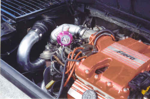

I have about the cheapest turbo setup I think one could manage (for now). I'm bolting on my turbo to a stock internal 88 block. I'm just doing this for now while I build up my other motor with the stronger internals. I like to do it this way so I can get all the quirks worked out, and the tweaking done before experimenting on a freshly rebuilt motor.
Modified stock Y-pipe
Camaro Muffler
IHI VF30 turbo
TurboXS BOV
Xtreme manual boost controller
Saab 900 Intercooler
GM knock sensor/ESC
1985 ECM (chipped)
Perma-Cool oil Cooler & thermostat
Remote Oil filter
NGK plugs, MSD ignition
Hmm.. thats about every single mod I've made to this car, lol. It should be completed this weekend if weather holds up, otherwise upcoming week.
