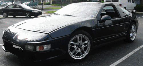

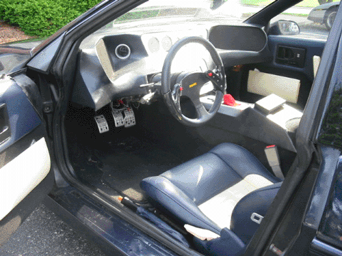

My original thread was lost, so here's a summary for new members. My 87 GT has been a struggle from day one to get things done in a timely fashion. I finally decided to pick up my incomplete project up knowing that I would get things done faster. There are still many mods that I have planned, but she's coming along rather nicely.

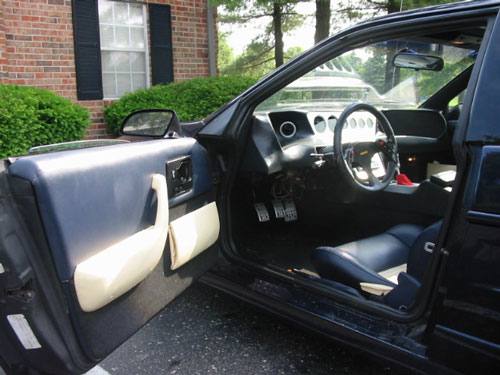

I decided to change the interior to a blue and Lambo cream color scheme. It works well with the color of the car. I also have custom blue/cream floormats that are soo nice that they are for show purpose only. The seat belts were also custom made with blue thread. The seats are Mr. Mikes, as well as the doors. The seat belt cover and seat adjust are also wrapped in leather. The center console will be modified to fit the EPX-2 controller w/ switches. The stereo is very remarkable... Anyone from the Bob Stieger's show that can testify?

87 GT, 5spd, 12" Wilwood brakes, Front slalon racing suspension, 88 rear cradle, coil overs all te way around, crate 3.4, FOCOA headers, overbored TB, Accel 300+ system, back-up Optima red top battery, competition stereo system, custom footwell sub box, 17" front 18x9 rear Ronal LZ wheels w/ P-Zero tires... Okay... Okay... I'll stop there, or it will get old real quick.

What size tires are on them wheels?

The fronts are 225/35/17's, and the rear are whopping 265/35/18's. I'm thinking about swapping my new 3800 Series II SC into this one just to justify the tire size.

I don't think I've seen an interior color combo like that in a Fiero yet. Very cool.

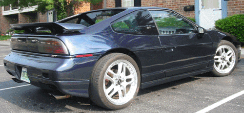

Can we get some pix from behind the car so we can see how wide the 265's are?
Sure, I'll get some more this weekend. Any other requests?

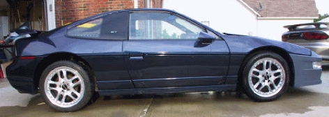

Yeah, how about a perfect side shot with the front wheels pointed straight foreward? I have always loved 17/18 combos, but never seen it on a Fiero.

Yes, a shot from the side with the wheels straight forward would be nice.

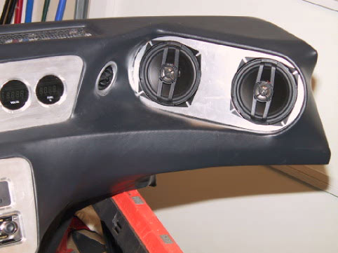

Report this Post06-06-2003 03:14 PM Click Here to See the Profile for FieroGTguyClick Here to visit FieroGTguy's HomePageSend a Private Message to FieroGTguyDirect Link to This Post
FieroGTguy
3087 posts
Member since Mar 2001

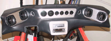

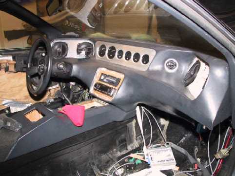

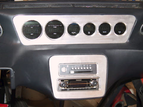

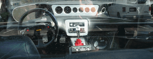

More Dash...

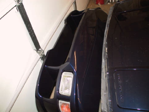

FieroGTguy
3087 posts

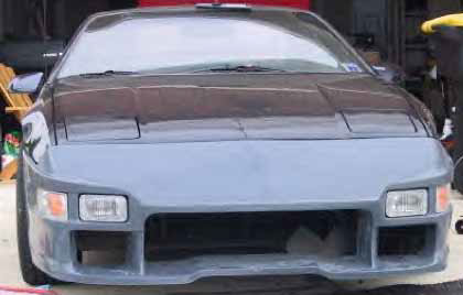

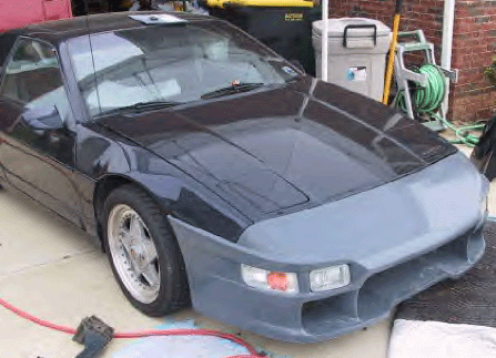

More Bumper in Progress...
The bumper pre-install after it was painted...
A side shot without the 18"s installed...

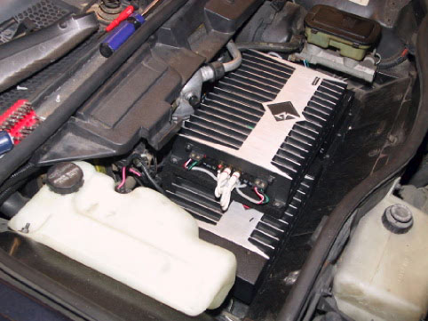

And my amp rack. Still need to add some flare to it. The heat doesn't bother the amps because Rockford pieces run pretty hot anyway.
They look much better with the end caps on.

For your stereo, where are the sub(s)? What brand of components are you using? Are they seperates (they look like seperates with custom mounted tweeters on top), running an EQ? What model deck is that? (Looks like a Pioneer at a quick glance)
Yes, thats a bunch-o-questions, but im looking at doing a custom audio dash too, so i obviuosly have some questions :P
Once this project started, I was eager to get all the parts needed for my system. That was a mistake, because waiting for the work I couldn't do that needed to be done before the install took years, and my components are probably obscelete. Since I forked over the dough, I went with what I got and am more than happy with it still. A future upgrade is eminant. I hope to get sponsered, and go with a simgle brand with their "good stuff". But here is what I got excluding many model #'s because I forget, heh:
Deck = Pioneer CD/MP3/CDR Player
Dash Speakers = Dual MB Quart's that were the best bridge model under their Q series components.
Amps = Rockford Fosgate 360.6 (3 channel) 60 watts to each 3 sets of speakers. Rockford Fosgate 250.1 mono sub amp 500watt RMS x 1
Sub = 10" Digital Dynamics Audio sub (9100 series, I believe). PHAT dual stack polished magnet w/ carbon fiber cone! www.ddaudio.com (1200watts RMS) I made a custom footwell sub enclosure to fit the monster that makes it look stock.
Crossover/EQ = Rockford Fosgate EPX-2 symetry system (the controller is pictured resting on the console).
Misc. = I am running a high output isolator to the most expensive red top dry cell Optima battery I could find that the sound system runs from. That way, I can run the system down all the way at a show, if I wish, and it won't affect the battery the car uses. Once the car starts, the alt charges both batteries. I originally planned to use a Stinger dual output alt, but there were problems. I also am running monster cables, and twisted spearker wire in a sheath... You know, the expensive kind.
I can find out more info on request, but that's it in a nutshell.
Greg
*edited because I may not have been the first to create a footwell sub box... But the first to offer a 100% form fitted 10" fiberglass box open for sale on the lists, and post pics and help others make their own back on the .org fiero list. My point was that it was not a copy of any kind, and that I contribute to the Fiero community when I can.

Originally posted by R Runner:
That is some really nice work. I am impressed. I played with the sound stuff for about 10 years in many different cars and I have seen plenty of competition cars. Yours looks great! I love the redesign of the dash for (i'm guessing) what IASCA would call a sound stage. I'll bet your imaging is fantastic. I like the performance upgrades too. Nice touch. I hope I get to see it at the 20th.
That's kind of a funny story about the imaging. I have never owned or tuned a stereo system before this one. I've always read discussions about the topic, but never actually heard what they were talking about.
The first time I heard the system was without a sub, and was unlike anything that I expected. The front sound stage was so fantastic that it took awhile getting used to. The sound must reflect right off the windshield directly at you because the image is awesome! The source seems to float from right above the gauge pod. I see why they call it a sound STAGE now because it really is like you are listening to music LIVE!
I'm tickled every time I drive her. I just need to install a custom 3.4 chip to address the erradic idle on startup. Remount the bumper because I am a perfectionist. Add side scoops, and a chop top + modified 3800 SC will be in its future.
It's a neverending work in progress, so there will be plenty of updates for years to come.
Greg

Are you going to compete with your system? If so, i do believe that all subwoofers must be located behind the "imaginary line" which is from the end of the rear-most doors and back...
I am surprised that you didn't put the sub behind the passenger seat (in the firewall...that sounds like the best option to me (which is why i did that)...
Congratulations on the dash..very nice...VERY nice...
How much do you have invested ($$) in that dash - parts, finishing costs, etc?
-Blaine/FieroAudio
FieroGTguy
Posts: 3087
From: Indianapolis , IN
Registered: Mar 2001
Total ratings: 101
Report this Post06-09-2003 09:28 AM Click Here to See the Profile for FieroGTguyClick Here to visit FieroGTguy's HomePageSend a Private Message to FieroGTguyDirect Link to This Post
I had to help my friend move, so I didn't have time to get pics, sry. I want to use his far better digital camara. :P
I've never competed before, but I've had serious thoughts after my upgrade. I chose the footwell because the sub depth is huge due to the dual stack magnet, and I'm not a fan of forcing anyone closer to the windshield than they want to be.
If the footwell sub violates IASCA rules, then I would probably run extra wires for an impromptu behind the seat installation until I fabricate something more show worthy.
Just FYI... This car wasn't purpose built to be a trophy collector or trailor queen for sight, sound, or speed... But my goal is to continue improving what I can in each catagory. It isn't much more than my personal hobby that I love to share with whomever else appreciates it.
It's my daily driver, so it is prone to rocks, chips, + scratches. It would be a shame if I didn't enjoy it for the fear it might get damaged.
As far as costs involved. I think the builder said that he could make a similiar dash uncovered for about $4000. Once you add the system hardware of your choice, leather of your choice, steering wheel, MOMO shift knob, MOMO aluminum racing pedals, labor, etc... It becomes quite an expensive project. I'm slowing my allowable investments in order to save for a house so it doesn't get to the point it is either a house or keeping the car.
I'll get pics asap, but I have a hectic work week. It's really cool that everyone can share their interest to keep pushing everyone to better their Fiero. Skitime has raised the bar for Fiero excellence, and has done everything I have researched doing to mine, but did in in his unique way. Kudos to Skitime!
Greg
