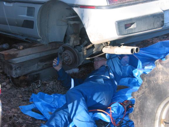

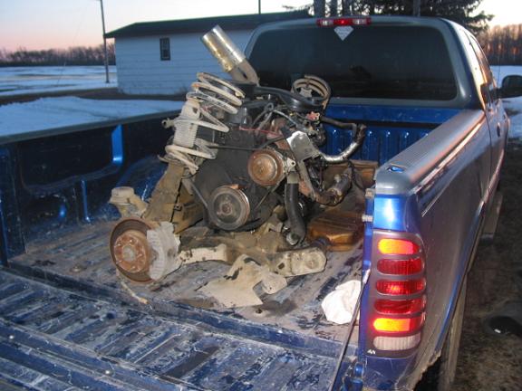

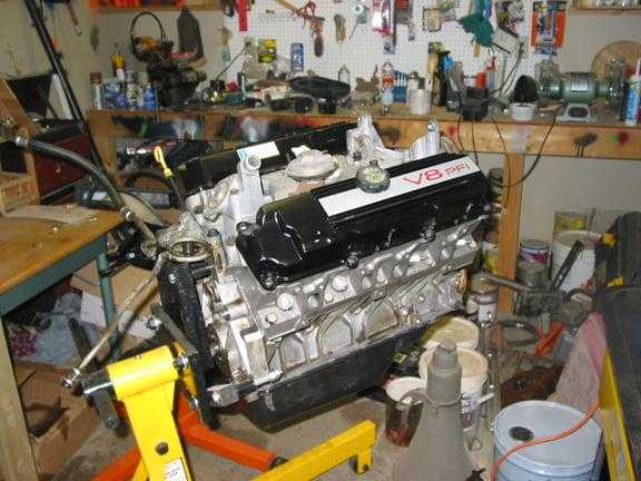

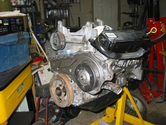

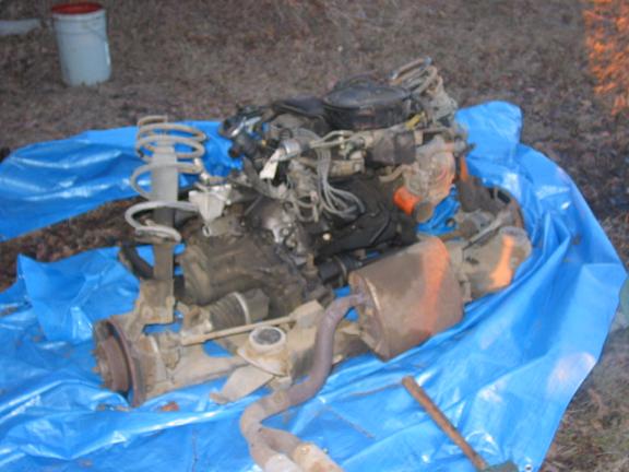

Well, since this seems to be the thing to do nowadays I'm going to show you my 4.9 conversion.
My Fresh 4.9, I rebuilt it and replaced all the gaskets and waterpump.

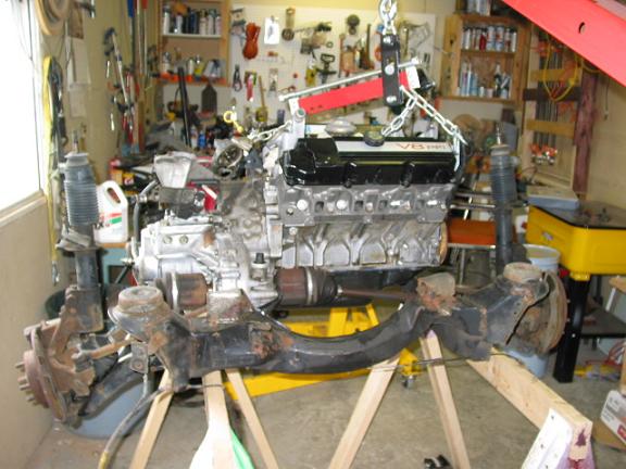

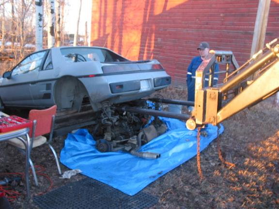

I bought a 86SE sight unseen so I could use its engine cradle and transmission before I tore into my 87GT. I drove 5 hours to pick up the car which turned out to be an 86 coupe with SE written on the side. It was an honest mistake, I can understand the confusion.

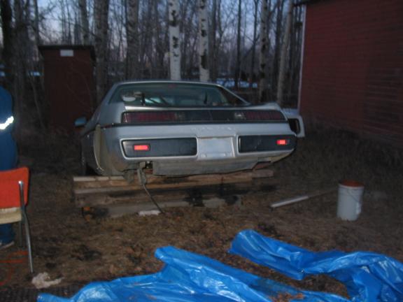

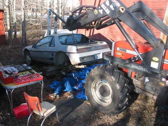

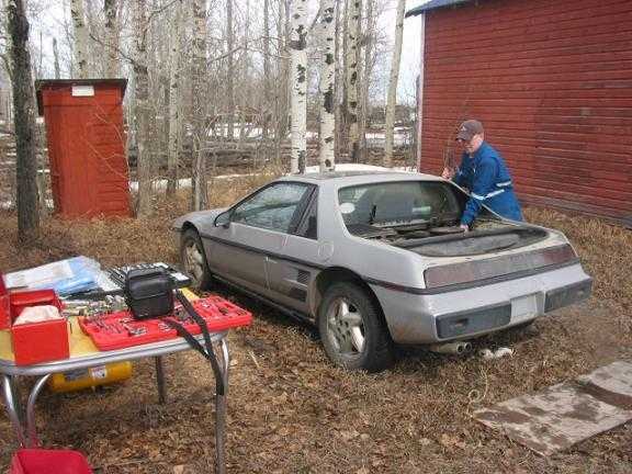

Today I removed the engine cradle from the coupe, it wasn't hard but definitly time consuming. I'm not sure but I may be the first person to use farm machinery to do so
cont...

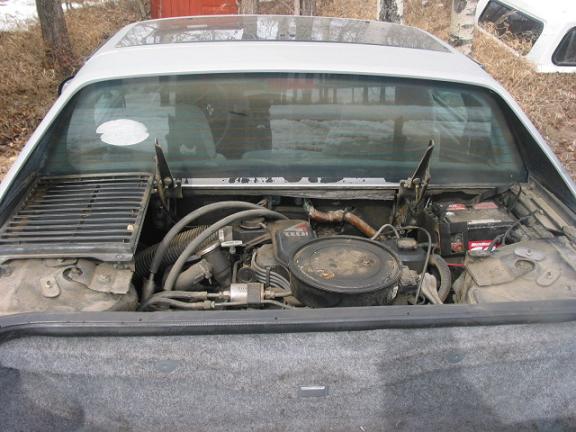

Tomorrow I'll be taking the 4cyl engine off the cradle. I'll be posting more pics as soon as I get some more time off work.

This is off topic but in one of those picture is that an out-house in the back? Just curious.

Way off topic: I bought some parts for my old MR2 from a gentleman with a tractor - dont ever lift by the strut tower brace!!!!!

Nice tractor.

Great pics. I love the usage of Farm Equipment - I think that's how most NASCAR guys started out in the 50's. Almost nostalgic. Good luck on the swap. 4.9L's were great in Caddys, it's even going to be nicer in your ride.

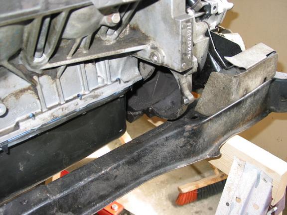

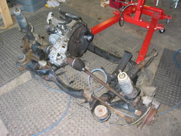

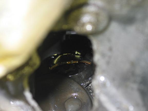

Well here is what we did today. We seperated the engine from the transmission and found out what was knocking...
And a closeup, you can see the metal debris inside the crank case.
87GT 4.9 in progress!

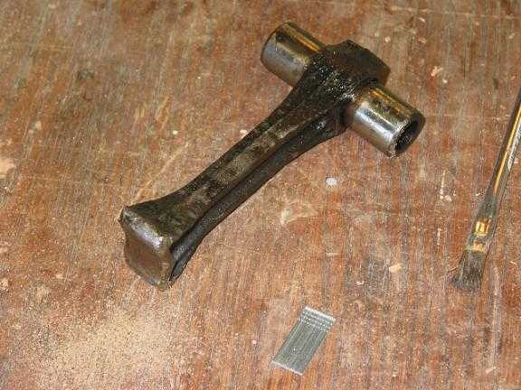

Engine cradle is now on saw horses and the 4.9 is ready to go onto it. Just need to buy a new clutch and have my cavalier flywheel machined.
and a picture of what we pulled out from the hole in the block. Nice Connecting rod!

And yes, that is an outhouse lol!

THis must be a commen place for a 2.5 to throw a rod i have had 2 of them throw the rod in the same place.
check out how thin the walls are on the 2.5 block is very thin.

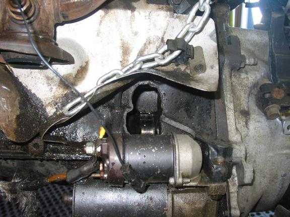

Well I have some updaes on my progress

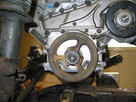

I have the engine mounted to the transmission. It really is a very nice fit, almost like a V-8 was meant to rest on there.
you can see the clearance of the crank pully, there is quite a bit of room. I still need to level the engine and take measurements for engine mounts.
You can see here where I need to notch the bellhousing for the cadillac starter. Again, lots of room on the side of the engine.

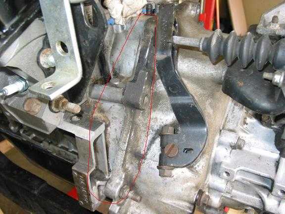

Here you can see where the engine meets the 5 speed Isuzu. This was a surprisingly good fit.

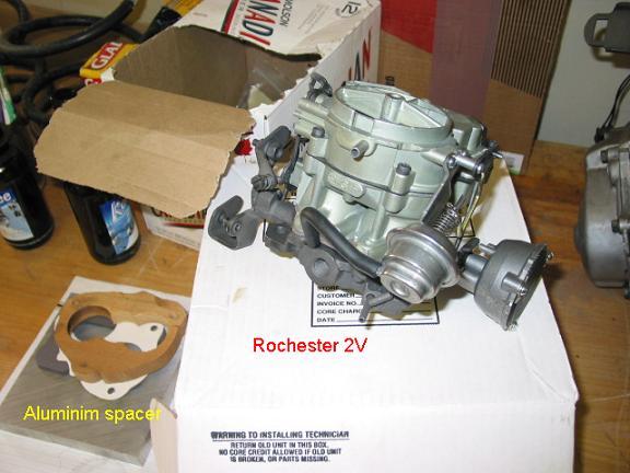

Here is the carbourator I bought for my swap. Its going to flow about 350-400cfm, should be enough for this engine (crossing fingers)

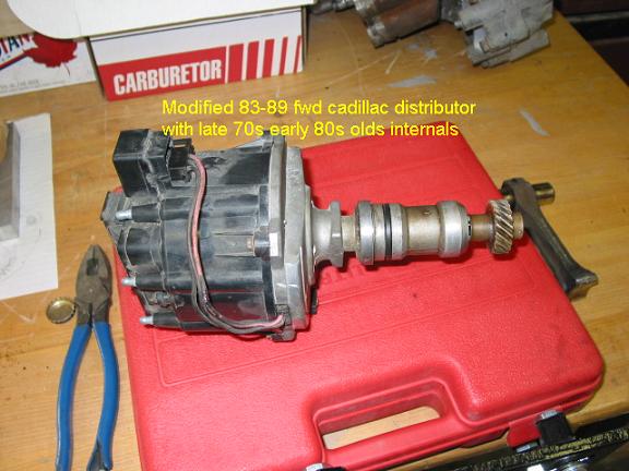

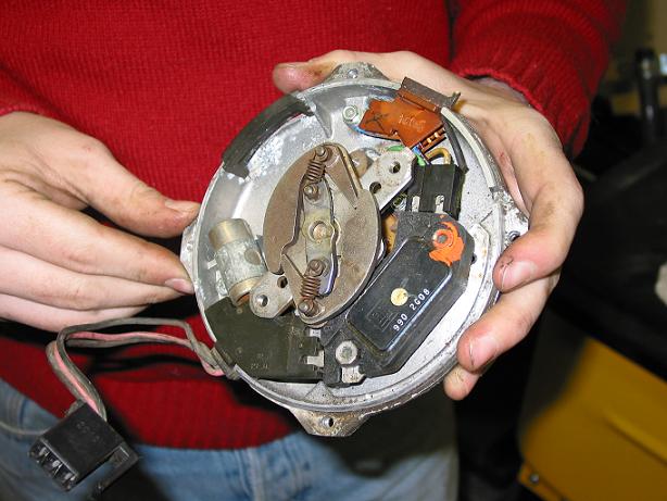

Here is the distributor I had to make. It has mechanical advance from an olds engine. For anyone who is going with a carbed 4.9 you should know you can not use the 4.9s distributor. I found this out when I had the distributor almost built. You must go with an earlier 4.1 or 4.5 distributor.
as you can see here the 4.9s housing is too "deep" for the olds rotor and it will bottom out and never rotate
Here is another look at the 4.9 shaft vs the olds shaft. There is a definite difference. The earlier cadillac shaft is the same length as the olds.
Did you find all the seals and gaskets in a kit somewhere, or have to buy separately? Do you happen to have a source and/or parts list for the seals?
thanks
--Dan

Thought I saw Red Green peeping out from around the outhouse! Good use of the farm machinery!
thanks
--Dan
I actually got a gasket kit from Canadian tire. Its a felpro kit but it is missing some key gaskets. The kit cost me $300 Canadian but the extra oil pan gasket and timing cover cost an additional $100 from GM.
Sorry it took me so long to respond, I has no idea anyone was still replying to this thread.

Report this Post07-10-2003 12:34 PM Click Here to See the Profile for GTFiero1Send a Private Message to GTFiero1Direct Link to This Post
i somehow doubt that carb will flow to the engine's needs, will it runs with t? Sure it will, but it will probably nock the power down to that of a 4.5 or less, should have gotten a 500 CMFer
--Adam--
1987 Blue GT 5-speed
IM AOL: FieroGT5speed
crzyone
Posts: 3571
From: Alberta, Canada
Total ratings: 176
Report this Post07-10-2003 09:52 PM Click Here to See the Profile for crzyoneSend a Private Message to crzyoneDirect Link to This Post
Dude. Bubbajoe and Stevenrossi are running the same carb, they have no issues with lack of power. Joe claims equal or better acceleration than PFI. This is what he claims, don't start flaming me.
At 5000rpm this engine needs 390CFM. I don't see how its not going to flow enough air.
This carb is off of a chevy 350, has almost a liter more displacement. I'm sure it'll do just fine.
I'm looking for bottom end grunt, I have a wet nitrous kit to help out the top end.
For those of you that want a 500cfm rochester they came off of large trucks with 454s. Nice big 2 barrel.

Report this Post07-10-2003 11:00 PM Click Here to See the Profile for Monza76Click Here to visit Monza76's HomePageSend a Private Message to Monza76Direct Link to This Post
Back in 1976 I new a guy who put a 650cfm Holley on his 4.3L Chevy Monza, I put a 450cfm spreadbore Holley on mine. His was hopelessly overcarburetted, bogged off the line all the time, mine was fine, and quicker, since the small carb left me with lots of low end torque. The old way was to put on a big carb and lots of cam for the big power numbers, fine for an SBC or a BBC but for this little Caddy, you only have about 4500 usable rpm (5000 is pushing it) and there are few performance parts so go for the fat torque curve by using a smaller carb. As already pointed out, at redline the engine only needs 390cfm so the carb is good throughout the usefull rev range.
