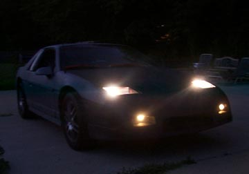

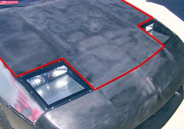

Just thought I'd share my current project. I'm still working on them, so any comments are welcome.
Heres a few pix.
As you can see I modified the hood a bit to make for more light output.
From the side

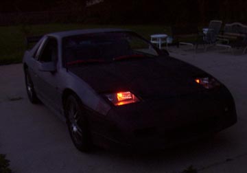

New parking/turn signal location

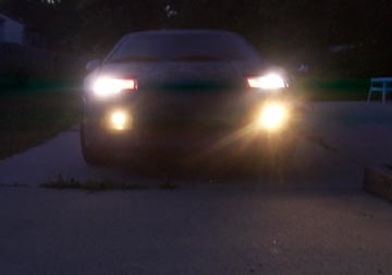

Night shot
And one from the front
One more that shows how the lights dont bolt to the hood, but the car. Unlike other flushmounts.
I have to start the fiberglass work for to make them look good, but they are way brighter than factory. Anyone know what the lights are from?, If you can see them that is. I got more pix from the start of the project and I can take a few more if anyone is interested. Like I said I'm still working on them, since I'm not 100% satisfied yet.

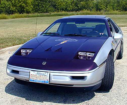

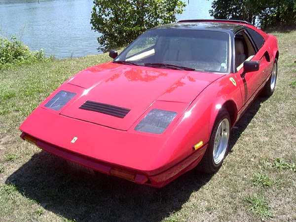

Here's mine ( err Tom's/cadaver's) works for me

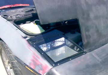

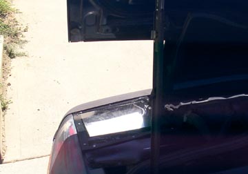

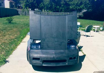

More pix.
From a distance

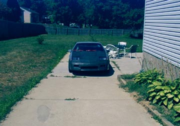

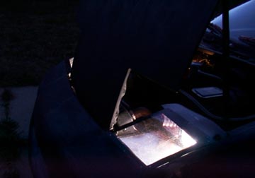

Hood popped front

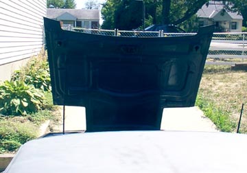

Hood popped from rear
Fixed lights, hood popped

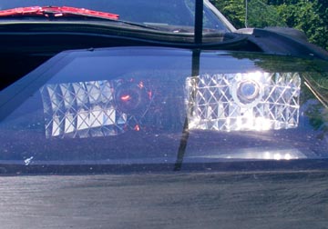

Close up lights
Hood popped 3/4
This one show where I bolted it to the fender and fron bumper, and the yellow shows where the fiberglass housing will cover. If anyone wants more pix or has any questions just let me know. Thanks for the comment, I'm glad they don't just look good to me. I was worried that they were starting to turn out like crap.

Originally posted by Hybrid2M6:
I used these.
What's the Height and Width of these lights? They may be cheaper option for people wanting to add a Driving Light/Signal Light combination in the stock signal light location... Anyone??

I dont like any of the flush mount kits ive seen. But i like yours. The modified hood is the best way to go IMO, makes them look like they came there and not some cheap add on. I dont think id put them on my present GT but if i had a black fiero, id put them on it. (I just think they'd look best on a black car )

before any of you jump on the 300Z lites, know that there will be considerable glass work required. The front of the Fieros hoods are mostly straight across at the front near the ends where lites go. Almost a 90* turn to the sides with only a very slight rounded corner. The 300 lites are glass (therefore not modifable) and the front edge is very distinctly curved. They barely fit in the F40 kits which were designed to fit them. My hood is cut out in the corners around my flush headlites too so that they stay down in the nose when hoods open. The lexan fits the larger opening perfectly, in fact those seams are the tightest ones on the whole car. People who dont know think mine is built that way from the factory for which I take great pride. The sides of my lexan are painted body color so it looks like the clear glass is a separate piece that no one can figure out how its mounted. There velcroed on for ez access and cleaning, and I havent lost one yet in 2 years and I assure you they have been thoughly 'speed' tested I have seen a few done that were OK, but a bead of silicone around the glass doesnt look too professional.

Glad to see the ideas working out for you. For those who havent seen mine> BTW, stock headlites could be replaced back in in less than an hour, but hood would have to be repaired/replaced.
