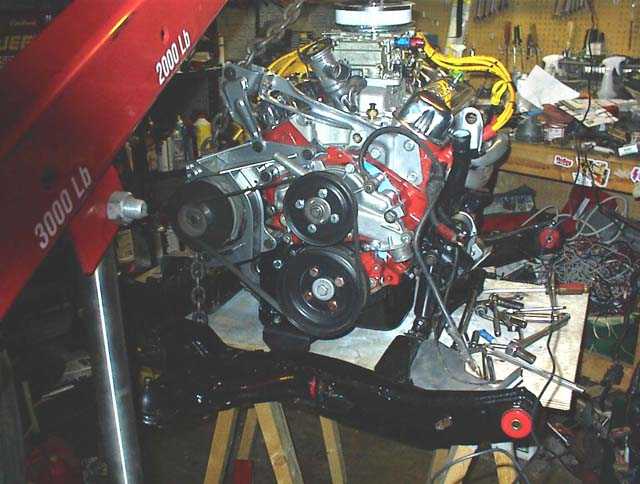

Well as of yesterday the engine is in.
The brakes are all hooked up. All that's left to do is hook up the coolant lines and on Saturday the Borla exhaust will be here.
Just have to install it, fill the cooling system, install the battery and fire it up!
By next Sunday it should be on the road again!

Nice, what engine?

Originally posted by Razor_Wing:
Nice, what engine?
This one: (It's a built up 3.4L)
fierogt3

Report this Post09-21-2003 10:46 PM Click Here to See the Profile for fierogt3Send a Private Message to fierogt3Direct Link to This Post
That looks awesome!.....what are your expectations out of her?
This set-up has 223hp/239 torque at the flywheel and the trans dyno'd at 17.4% loss.
(Which is excellent for an auto trans.)

What intake/carb setup are you using? I've been looking into that as an option on my 3.4 to finally get rid of the idle surge
Manifold ~ Edelbrock Torker II for a 60* V-6
Carb ~ Holley 390 CFM 4-bbl

Oreif,
Looks very nice. I'm sure it's gonna be a monster. What rpm range will the engine shift at safely? Couple of questions. Were there any particular issues for Not choosing the DOHC 3.4 instead of the sohc? Your power range might have been higher with it because of the better breathing and volumetric efficiency.
Are you planning on using any special fluids, like B&M trans fluid, Royal Purple Tranny fluid, or oil- synthetics?? What kind of compression will you be running? Fuel octane?

Originally posted by Bazooka:
Oreif,
[This message has been edited by Bazooka (edited 09-22-2003).]
Engine redline is 6500RPM.
The trans was built and dyno'd to match the engine.
I didn't choose the 3.4L TDC due to the reliability issues of the timing belts. The engine I have isn't a SOHC, it's a pushrod engine out of a 94 Firebird.I bumped the compression up to 9.5 and tossed in a large cam. I'm using mobil 1 oil and normal trans fluid (dextron III) The trans will work fine especially with the new trans cooler.
I'll most likely use 93 octane normally due to the increased compression and high lift cam.

Oreif,
6500 is plenty. Did you use a special shifter in the console? Do you have the 125 3 spd, or the 440T4 4 spd? The trans cooler is really essencial but it was a real tight installation when I did mine in front of the rad. I've seen some straight line coolers that could work under the rocker panels, maybe next to the antifreeze coolant tubes. My slip about the sohc, I did mean Overhead Valve engine.
Did you rebuild the tranny yourself? If not, is it someone in the area? The 9.5 c.r. is a good compromise. You can probably use most available octanes at the pump. I have real high compression on my V8 and need 93 or better and it's always more $. Did you run the stock electric fuel pump?
Oreif,
Stock shifter with a TH125 trans. My trans cooler is the B&M Street rod version. I have it mounted in the side scoop. It fits right behind the aftermarket scoop.
The trans was rebuilt and dyno'd by Roadmaster Transmissions here in Schaumburg.
They built it as a heavy duty trans (heavy duty clutch packs, shift kit, etc.) and dyno'd it with a 3800 (It was the closest engine to the power I'm putting out.) The trans has only 17.4% loss thru it. Which according to them is very good for an auto transaxle.
I'm using an external electric fuel pump. The Holley "Red".

Did you also rebuild the engine? bearings, pistons, rings, rods? How about head work? Port, polish, SS valves, roller rockers?
Great job! BTW, how far from Bloomington are you?.......Paul
stock pistons and rods, new bearings, cam. Heads ported, SS valves, roller tipped rockers, heavy duty pushrods, performance lifters, ported intake and exhaust manifolds,
re-curved distributor, double roller timing chain, Hi-Vol oil pump, etc.
Basically I started with a bare block and worked my way up matching everything.

Have you dyno'd it?
I'd be interested in tossin' my computer and using a similar setup.
Hell, that makes the 2.8 comparable to a 3800 S/C if those numbers hold up...
Can you post the complete parts list so I could duplicate it???

How high does that carb sit up? Does it clear the standard decklid? I'd like to see it with a shaker hood ala Bubba Joe's 4.9....

Originally posted by Rob Ernst:
Have you dyno'd it?

Engine is:
1994 Firebird 3.4L
Edelbrock Intake manifold with 4-bbl riser.
Holley 390 cfm carb
1984 S-10 Distributor
Colye's Double roller timing chain
Comp Cams 1.5 Magnum roller rockers and Heavy duty pushrods.
Edelbrock camshaft and performance lifters.
GM performance parts balancer and Hi-vol Oil pump.
Holley "Red" Fuel pump.
Darrell Morse brackets
WCF engine/trans mounts
Pro-thane cradle/control arm bushings
Fel-Pro gaskets
ARP studs and bolts
Rodney Dickman Tach filter, replacement connectors, and low temp fan switch.
Crane Fireball Ignition system.
Accel 8.8mm Spark plug wires
