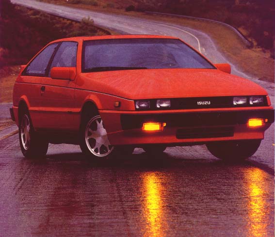

Here is a picture of the Impulse and a quote from the Isuzu spotters guide:
The Impulse was introduced in the US market with little change from the Ace Of Clubs concept car. The addition of slightly larger bumpers to meet the 5 MPH DOT requirement, shortening of the windshield and lengthening of the hood to allow for easier installation of the engine on the assembly line, and enlarging the overall dimensions a few inches to allow more interior space in anticipation of sales in the US market being the only significant changes from the concept car. The Japanese market equivalent, the Piazza , became available in 1981, but crash testing and DOT certification delayed the vehicle's introduction in the US by several years. The 1983-84 models were all non-turbo 2.0 liter SOHC. Outwardly, these models lack any rear spoiler or front air dam. Distinguishing features of earlier model Impulses are the headlight eyebrows and plastic inlaid tailgate garnish. The standard 14x6 alloy wheel was the aluminum color tic-tac-toe style with twelve inlaid squares with black accent, arranged similarly to a tic-tac-toe pattern.
Taken from: http://kourt.dehaas.com/vehicles/
Razor_Wing take DjDraggin's suggestion and try that program. No offense meant but sometimes it is hard to read.

Report this Post08-15-2003 08:07 PM Click Here to See the Profile for RaydarSend a Private Message to RaydarDirect Link to This Post
<snip>
And that has what amounts to a Chevette suspension?!
I never woulda guessed it.
I drove a Chevette for about two days. (It was a rental.) One of the most uninspiring cars I ever drove.
Always thought that generation of Impulse was a beautiful car. Still do, for that matter.
Thanks for the info!
