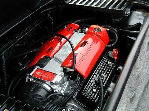

I like the other engines like the 3800 and the 3.4, but if I were to change my engine it would be an LT1. I looks great in a Fiero and it just sounds so good. The 3800 is a great engine, but lacks the "impact" of see a corvette engine in a Fiero.
You can not say this does not look great!

LT188GT
Posts: 5201
From: Miami Fl
Total ratings: 100
Report this Post08-03-2003 05:13 PM Click Here to See the Profile for LT188GTSend a Private Message to LT188GTDirect Link to This Post
Proud88GT. Thank you for showing my LT1 installation. Was that shot from the Daytona Show this year? Thanks to Archie for the install as it helped me take a first place modified award at the show.
88GT LT1 5SPD
