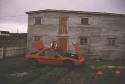

It all started in a barnyard:
with a 1984 econo coupe that had been sitting there for over 6 years, even the recalls had not been done,
After repairing the starter, clutch, and brakes, a set of trim rings and some black paint made the 13" steel wheels presentable, but this was definitely temporary.

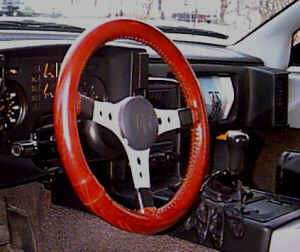

The steering wheel was soon replaced with a Grant wheel made by RAID in Italy back in 1976, I originally bought it to go in my Monza (76 of course). I later sewed the brown leather to match a 1980 VW Rabbit interior. Turns out the adapter kit for GM didn't change so it bolted right in.
By now I had discovered the mailing lists and had found some Dodge 14" wheels (cut down the original Fiero hub caps to make the centre caps) and a set of Paul Mackibben fender crests:
But the 1984 had electrical problems which were a little scary (kept frying light switches) I attempted to fix them:
but it still made me nervous. (this setup was neat though, when you turn on the headlamps with the switch they rise, but when you turn them off they stay up until you push the button to ,lower them ) That is when I found the 1985, it looked good, it ran and it had no electrical issues, just lots of suspension rust. I transplanted the rear subframe from a 1984, and then the front subframe from my 1984. I mounted most of the 1984's interior, including the shorter shift lever, painted the panels red, mounted a set of Alpina pedals my 11 year old gave me for Christmas, and a set of seat covers from my oldest boy to cover the typical hole in the seat:
Note that the horn button is the original Fiero wheel centre, all I had to do was bend the clips a little and it snapped right on (and it works)

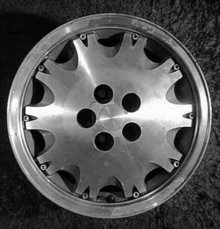

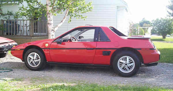

By now I had gotten a set of Grand Am 14" alloy wheels, but I had just played around with paint on the 1984, the clearance was too tight at the rear. Then I met a Fiero owner who was willing to trade two Fiero wheels for two GA wheels, here is the result of the different offsets (Fiero 35mm, GA 47mm):
Actually has some impact on kickback at the front and it gives the illusion of wider rear wheels.
Next a friend of mine said he had found a really good Dodge Shadow wing for only $40:
Here it is painted and mounted.

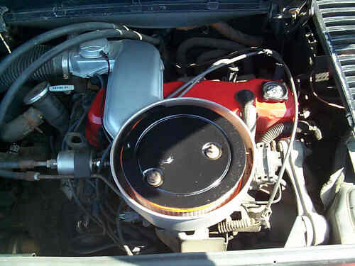

Next came the evolution of the underhood "look", from painting the air cleaner:
Too also painting the valve cover:
Too making an open cover from a spare intake:
Too cutting down the rest of the extra intake to match:
The Holley scoop I bought from IRM for the 1984 is now an engine ventilation scoop. I have since removed the wire looms because the aftermarket plug wires were too short to follow the factory routing.
(I still have the original intake, the one I painted red and silver, so I can revert back to stock specs quickly)

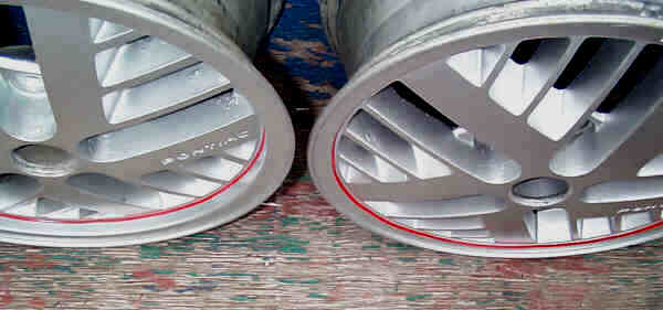

Scratch that, I now have a set of 86/87 GT wheels, 15"X 7" courtesy of Fiero5 and Bob Parker Any one in Newfoundland have a Fiero or a J-car and want a nice set of 15" wheels, I can point you in the right direction.

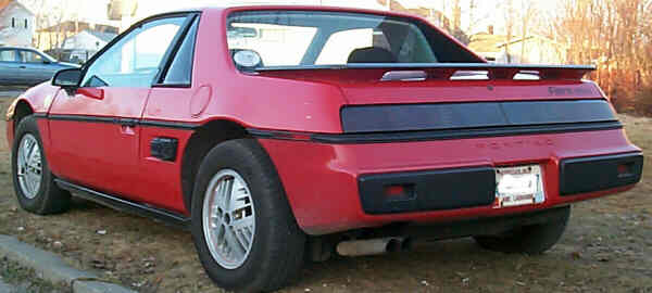

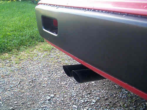

I have the exhaust tips painted black, sort of my reaction to all of the really big shiny exhausts I see all the time.

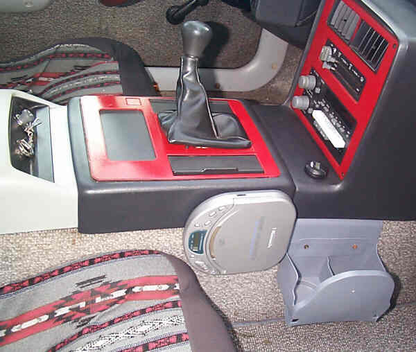

I have taken the cigar lighter adapter for a portable CD player and wired it so that I can mount it permanently (out of sight). I will then velcro the CD player to the passenger side of the centre hump and use a cassette adapter to play through the original stereo.
Following my cheap theme, these are items I already had.

JazzMan, I am hanging on in hopes of coming up with a set of 15" GT wheels (done), but I am still keeping an eye on these just in case someone nearby is looking for something like this. They are on a Daytona in a local body shop's back lot, not likely to be noticed by anyone else, so I may get them and either polish them or try your suggestion. I think they look a lot better on the car then they do in that picture. Check out these pictures (very low quality but they do show them on a red Fiero): http://www.k12.nf.ca/gc/Staff/Teachers/Crummey/fiero/ChrysWhls1.jpg http://www.k12.nf.ca/gc/Staff/Teachers/Crummey/fiero/84CoupeChrysWheelsGTNose.jpg

Ira, can I see some more pics of your painted black exhaust tips?
Monza76
Posts: 1298
From: Gander, NF. Canada
Report this Post07-15-2003 06:13 AM Click Here to See the Profile for Monza76Click Here to visit Monza76's HomePageSend a Private Message to Monza76Direct Link to This Post
Kruz
Here are the Painted exhaust tips, my digital camera does not have a macro mode so the quality may not be very good.
