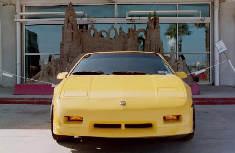

WOW. Great job gt boy. That alomost looks like mine when I first repainted it. You can see it at
https://www.fiero.nl/gallery/Cars/Sand31.jpg
I left the trim black and had I had the windowed side scoops in place of the stock quarter windows. Now my 87 GT has become a total project again and will be repainted again since there is a bunch of spider cracks in the front bumper from bumping someone with it and also side swiping a suburban which nocked my driver's side mirror off and chipped the paint off the top of the door panel. I will probably be repainting it sometime next summer in a color yet to be revealed. If I re-figure out PIP I will post a pic of what it looks like in my garage at the moment. One thing I have found out is that if you paint your own car you will always be your own worst critic when it comes to looking at the work you have done. Hope you get to enjoy driving your freshly painted beauty.

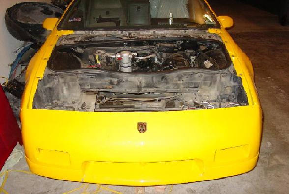

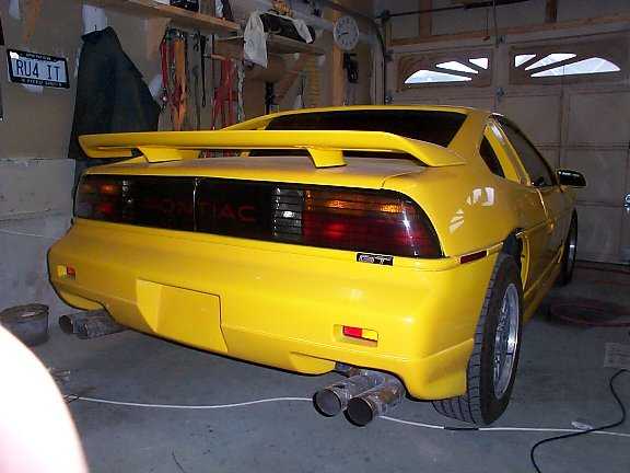

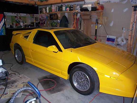

well for anyone who still cares...here are some pics of the car all together apart for installing some new quarter windows and the inner fenders i am done.
you can see the new tint on the windows and in the picture taken from the front of the car you can see the problem that i am having with the different shades of color. the fender is a different color from the hood, headlight covers and the nose.
i may be respraying the car complete less the mirrors and spoiler to blend in the paint. i will cross my fingers for this. until then i am a little reluctant to take it out into the world ..for i am really down on the job....i am sure i will get over this..but it might take a little time.

Let me guess.... the color variation you're seeing comes from the yellow paint being somewhat transparent? I thought I saw signs of that in one of your earlier pictures of the underside of the nose. Thats always tricky. The best way to solve this in your case, now that the car has been "panel painted" is to blend the bad parts. If its your hood-area thats not working out, what you could do is mask off the whole car except for the front-end above the belt-line. Have it sanded with something smooth, like 600 grit wet-paper. Then do a few blending coats across the hood and the tops of the fenders, attempting to even out the color difference. Then go once over the blended areas with some transparent-clearcoat to "glue-down" the blend area. Put a couple coats of clear over that, and you're probably set.
You sorta have to be careful what colors you choose when you plan on panel-painting a car. Anything thats got any transparentness is a bad choice, because paint thickness matters. If you do suspect your color is going to be transparent, you should paint the car with a more opaque color thats similar, or with white. And then add the color coat, being careful that you put the same amount of paint on all parts (tricky on edges, where you tend to shoot on a bit extra to make sure it wraps around).

thanks for the tips automoda...i didn't realize that this colour was that transparent. the car was painted white first ..but some of the panels have a dark color that seems to be bleeding through or the color is completely different but seems quite solid.
i am just going to respray the whole car altogether, and i may use my old reliable siphon gun this time instead of my hvlp gun...i may not have enough experience with that gun to do a quality job. ...i guess the best way to learn is from your mistakes...or doing it a few times over like in this case....
