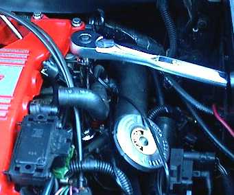

While I was trying to figure out another problem ( https://www.fiero.nl/forum/Forum2/HTML/039623.html ), I finally got around to installing Rodney's Low Temp Radiator Fan 185* Switch ($24) and his Stant 180* thermostat ($11) I bought from him at the 20th show.
Tools I used were a 3/8 drive ratchet with a 6" extension and a 21mm deep socket; pliers; and 2 flat head screwdrivers.

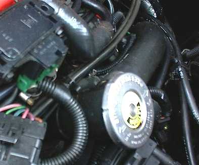

Here is a shot of the location of the thermostat to be changed and radiator temp switch (it can't be seen in the pic, but it is about 2 inches behind and then down about 3 inches from the thermostat cap), of course it is not easy to get at.

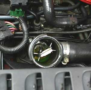

Here is a shot of the stock thermostat after the cap was removed.
Here is a shot of the hose I had to unclamp (with the pliers) to get down to the fan switch. You can also see the wiring harness in upper left that went to the fan switch. Naturally you have to press on both sides of the fan switch coupler to get it to release. I used the screwdrivers for that.
Here is a shot of the ratchet in action taking out the fan switch.
