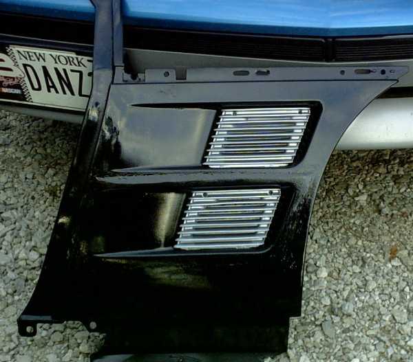

First off. I want to say thanks to KRMFiero and to FieroV6Dude for telling me how to remove the old panel and put the new one on.
Been working on it off and on for the last week or two, finally got it put on the car. Still not mounted right, need a couple more rivets 'cuz I broke a few, and then I'll be all set, but its close enough that I was ready to share First pic still isn't great, but its better than it was. Anyway. whatdya think?

I really like that it just look like it goes to me.

Looks pretty good! Are you going to make scoops for both sides?

What do I think? I think you need to lower it!
So, have you got plans to make it functional? Also, how the heck do you plan on making the right side vents? I'm not good enough free-handing a mirror image...I'd probably have to make some templates. You've got more patience than me to try the right side!
Looks good, try and get some better pics in the sun. Are the intake grates painted or just faded? Looks painted, draws more attention, I think its cool.

There's a slightly better first picture now...unfortunately its still pretty foggy this morning.

I know it needs to be lowered, but I'm afraid that front air dam wouldn't last a day in flnt if I dropped it
The intake grates are painted the same silver as my ground effects, I thought that'd be a nice little touch on there.
The other side will be a royal pain, but I probably won't get to it until 8th week at earliest, too much other crap going on with classes. If this crazy fog ever lifts I'll get ya some good pics of it.

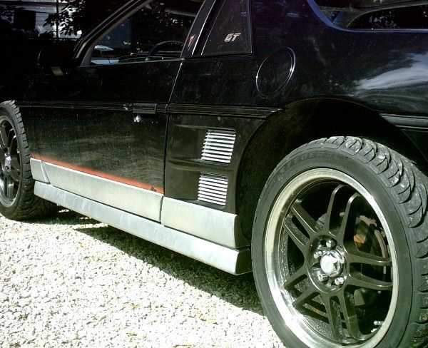

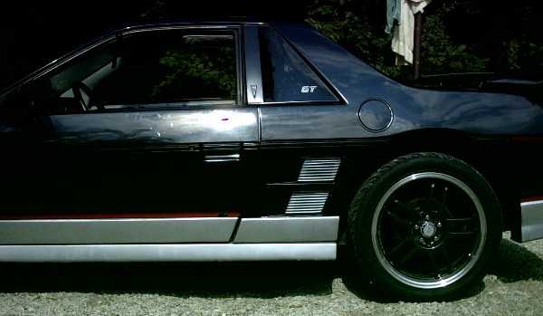

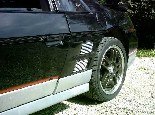

That's 'cuz Cliff was playing with the forum, but it appears he's gone back to the way it was.
Not only can you see the pics now, but it was sunny today and not raining on me, so I got some good pics (although the first one's still kinda lousy).

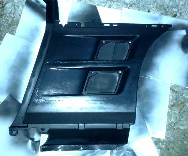

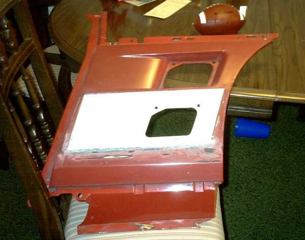

Well, since you asked.....
First I got two extra stock intake panels, then cut the stock air intake out of one and cut a hole in the other under the stock intake.
I then fiberglassed the cut out scoop into the hole in the panel, and used some bondo death putty to smooth it out.
Did some sanding and then threw some primer on it
Did a little more snading and then painted the panel black and the grills the same silver as my ground effects.
The panel I did this on, as you can see in the above pic, came off a car that didn't have ground effects, so I had to drill a few holes for mounting the ground effects.
Nice, relatively easy and inexpensive side scoop
