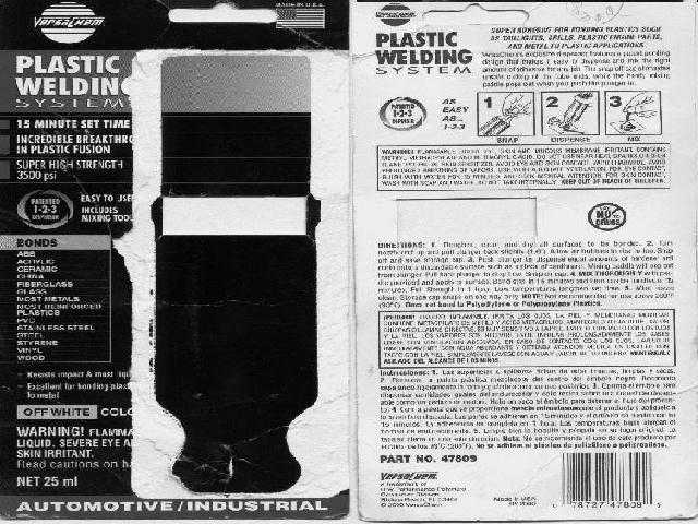

I've had good luck with this epoxy.
I glued my console back together a couple of years back and it shows no sign of turning loose yet. This stuff sets up as a rigid plastic and is the most workable from all the epoxys I've tried.
