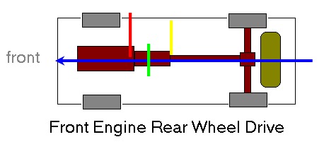

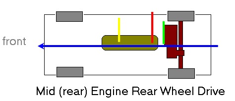

A fiero is rear bias even under braking and very much more so than a front engined car.
In theory, a perfectly balanced car the weight will be equal at both the front and rear wheels in a turn. The problem is that when decelerating that weight will shift causing an imbalance
Then there is the fact a body in motion will want to stay in motion and in a straight line. The heavy engine will effectively PULL the rear end out, it's that simple. Turning and braking in a fiero will not only take ground holding wieight off the rear but it will also pull it around.
Also worth mentioning is the "center of pressure" is ahead of a fieros "center of gravity" making it sensitive and snappy to directional changes. Put it this way if a fiero were a rocket it would be very unstable. The drag on the rear tires in a turn help it maintain it's stability but lessen the drag by moving the weight off and the force of inertia will take firm control of the situation.
Yel = CP
Red = CG during deceleration
Green = Static CG
Since the center of pressure is closer to the rear wheels and the CG is much further away from the directional wheels it makes this car much harder to take back control from the inertial forces acting on the rear.
The same thing works on a front engined car but the because the center of pressure is behind the CG it makes this car much more stable and seem lethargic since the weight is over the directional wheels. Inertia will still pull the rear around but since the CG is so far forward the rear wheels are more sensitive to inertia than to a shift in CG.
The center of pressure and CG is much closer to the directional wheels in a front engine car making it easier to overcome inertia should it take control of the rear.

Report this Post07-27-2003 03:10 PM Click Here to See the Profile for 84BillClick Here to visit 84Bill's HomePageSend a Private Message to 84BillDirect Link to This Post
84Bill
21085 posts
Member since Apr 2001
I hope you don't mind Ira but I used the images from your web site. It's about the only way I could describe the centers of pressure and gravity effectivly.
I forgot to mention that adding a roll bar and or changing the diameter of it will change the location of the center of pressure. Adding a larger front or rear tire will also change the CP and will add more stabilizing drag to both cars in a turn but more so the mid engine than the front engined car.
[This message has been edited by 84Bill (edited 07-27-2003).]

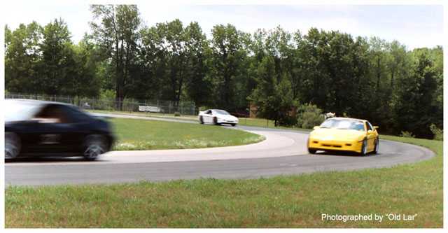

Yep...I sure do have some bucks tied up in the "Kid"!!! But more importantly, the knowledge of all who have worked on this car since 1993. A 'light weight' SBC conversion with the right suspension treatments will corner better than most peoples abilities on this Forum (myself included). You have to learn how to manage this performance to be completely safe (preferably on a race track). My spin out experience at Waterford was an extreme careless mistake, because I didn't remember exactly where turn 1 was in order to get on the brakes early enough (and I was paying attention to too many other things during the pass). My error was so bad, that even if I had a car that would pull 2 G's I would still be going to the pit.
One of the reasons I posted requesting any pictures taken of my car at Waterford, was get a look at how the chassis was performing in turns. One of the things I wanted to do prior to going to Waterford was to re-torque the front urethane sway bar bushing, but didn't (they haven't been touched in 3 years). "Old Lar" posted one picture that showed me the suspension was holding pretty well, photo was taken just as I had turned into the apex of the turn (road is crowned a little but the car is staying pretty flat on both front and rear).
Later that aftenoon I had learned enough about the track to put the "Kid" into turns with either front tire singing a song, and the back end remained solid. I really enjoyed the experience as I would never attempt pushing those limits on the street.

Sounds good to me Will but whatever you call it the principal is the same. I used the aerospace term because it makes the most sense to me. If you put a fiero on a pole it would want to put is arse end into the wind where as a normal car would nose first into the wind.
The logic is sound and I think it goes a long way in explaining how and why a mid engine car is radicly different. Even if the CT (as you call it) were behind the CG it is a heck of alot closer together than in a traditional car and it is known that the closer they are together the more sensitive a vehicle will be to directional changes.
Obviously cars are nothing like airplanes but one might be surprised how related they can be in how design efects performance. Some of the best performing aircraft are short and stubby (like a short wheelbase car) and the CG is much closer to the CP than a more stable aircraft. Unlike airplanes cars can use both the ground and air for stability and it's much more preferable that just air.
