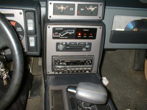

This is a shot of my stereo/nitrous/air-fuel ratio gauge. The stereo is just a piece of sh!t pioneer, but underneath is an AUDIO CONTROLER 5.1.

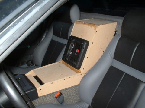

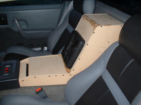

This is the new center console that i just built. It's made out of 3/8" M.D.F. I know what some of you are thinking. "3/8" is to thin for a box." I've fiberglassed the inside of it. So I think it's going to be strong enough.
The sub is a Kicker Solo 8". It might only be an 8 but it POUNDS pretty good.
This one shows the grill a little better. Surprisingly it's metal. It's a shad costly but it's worth it in my opinion.
The sub enclosure works out to be around .4 cu/ft.

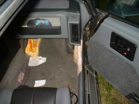

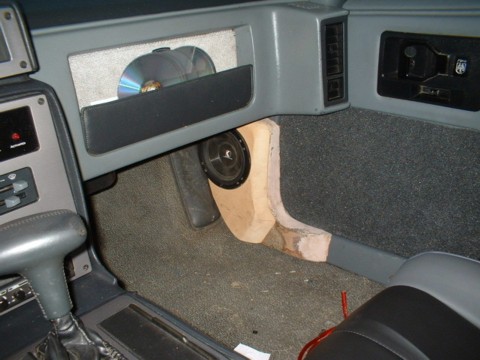

This is the kick panel style that my best freind came up with. It's 3/4" mdf cut to contour of the trim. It has a fiberglass edge to wrap around the trim. Mounted on the is 1" mdf to offset the magnet depth. I'm going to vinyl wrap it to match the trim colour.
This last one shows the "flush" mounting of the kick panel. My freind and I never liked kick panels the came out on an angle and took up leg/foot room. It might not be pointing at the "ideal" angle but it's better that than having some dumba$$ accidentaly cave in the grill with his foot.
The speaker is a 6 1/4" kicker impulse component set. The tweeter is mounted up above the dash in the pillar.
