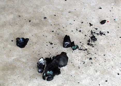

Thursday night, my friend Matt & I finally had the time to pull the burnt alternator. We had to actually use my dremel with a cutoff wheel to cut the main power stud from the back of the unit (seeing as how the plastic grommet that normally held it in place had completely burnt up). Thankfully it didn't damage any of the wiring in the area (although I did have to clean some additional dry-chemical stuff from the area).
This is all that was left of the rubber boot that used to cover the power lead/connection.

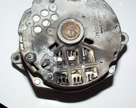

And this is how a brand-new lifetime-warranty'd alternator looks after it fails miserably!
I also found the receipt from the place in Indiana where it was installed... gotta call them today.

OK... one last update
I found the receipt and placed a call to the shop that did the install in LaPorte, Indiana. After realizing that I wasn't kidding about having had the alt catch fire (didn't take too much convincing) they talked to the shop manager about it.
Shortly thereafter they called me back and wanted to know if there were any AutoZones in my area (they are not common, but around). So I gave them the info for the one nearest me. Again, the called me back right away and let me know that the AutoZone had been informed of what had happened, and they had a replacement alt waiting for me at the desk.
I stopped by later in the day - swapped alts and some paperwork... and I've now got a "spare" again! I very much appreciated the effort that the shop made to help me get everything worked out so quickly!

Same thing happened on my pace car, just not so much burning. The stud coming out of the alternator loosened up alittle and got so hot the wire eventually melted to ground. Scary thing to have happen, its that burning wire smell that gets my adrenaline pumping.
