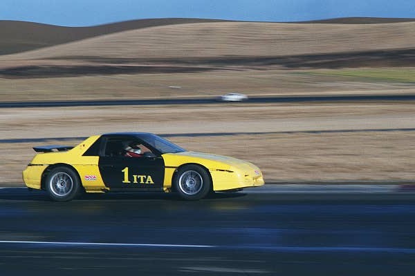

Here's a pic of my parent's neighbor racing - Alan Hamilton, SCCA member and instructor.
1988 V6 Formula with 86/87 SE Aero front and rear... Stock V6 engine - he runs in the ITA class.
I believe 4-cyls run in the ITB.

Kelvin, thanks for the photo! You are the closest to getting it right!

bHooper - The V6 Fiero would be in ITA. There are different weight limit depending on 85-87 and 88 models (88s have a higher minimum). All 4-cylinder models are classified the same I believe (ITB). These classes are very strict when it comes to modifications. That means none. You can blueprint what you have, but no after market mods or engine swaps. To do that you must enter one of the GT categories. I think GT1 is the only class available for the modded Fiero. You are talking about tube frame racecars at that point.

Most of the info above is correct. As Matt said, V6 Fieros run in ITA and 4-cyl Fieros run in ITB. 88's and pre-88s run together but 88s have a higher minimum weight. I don't remember the numbers.
