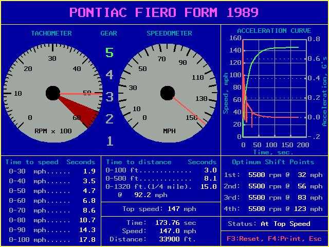

Plugged your numbers (except for the C.R which I made 8.5/1) into a program called car Test. The program is fairly accurate, but I think he simplified the tire model too much.
Test weight of 2895 lbs.
Aero CD of .365
Frontal area of 18.6 Sq. Ft.
Weight distribution of 42/58
The top speed seems high, but it's reasonable compared to other cars with this horsepower/size.
