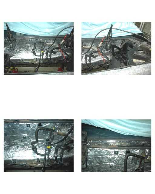

I preparation for the 3.4L install, I am cleaning up the engine compartment. I started with the firewall side first.
I bought this stuff from Jegs:
http://www.jegs.com/cgi-bin/ncommerce3/ProductDisplay?prrfnbr=31207&prmenbr=361
Removed all un-needed lines/hoses, removed all the stock black stuff, and installed the new stuff.
How's it look??

Here is a close up of one of the pics:

oooo...now stick that 3.4 in there!

Petty spiffy looking
Gotta wonder though,
think it's going to stay stuck on your firewall.
Tina
There is a high temp spray adhesive that you buy with it. I just wiped the firewall down with an acetone/alchohol mix to clean/de-grease then sprayed the Firewall and installed what I pre-cut/measured. The edges/seams are covered with aluminum tape.
Check out the edge just under the window.

Yep looks GREAT !
I used some a/c alum tape on the seems and The small amount I had left over from the floorpan seemed to be plenty! I sprayed some Krylon rust prevent on there first THEN used the spray glue!

Originally posted by My7Fieros:
Lookin' good Dave. I was checking out West Coast Fiero website last night and I believe they sell something like that as well. I'll be putting it in my Indy soon when the engine comes out....it looks much cleaner that way.
Get the spray adhesive from Jegs, I cut a piece and glues it to a painted bracket. 2 days later I tried to remove it using a heat gun. I was able to dis-color the insulation, but it never came loose.

Mine is the double-sided. The Ebay ad states that one is single sided but they do have the double-sided stuff available. The double-sided stuff is suppose to adhere better.

Heat shield looks great should keep engine out of the interior too.
