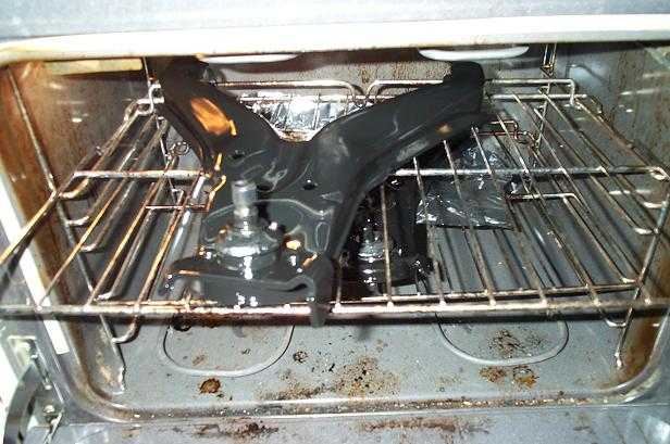

Ummm Ummm Roast A-Arm.. baked at 225 degrees for 2 hours for a durable suckulent finish

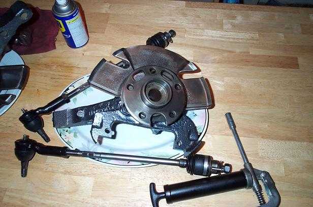

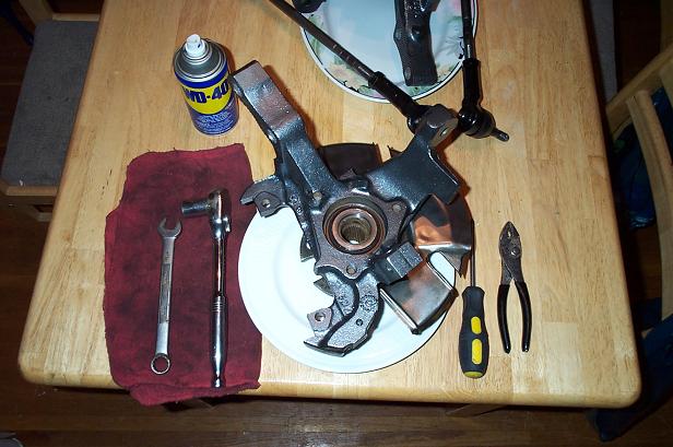

Ahhh and what is this??? Ohhh yes... Broiled knuckel of fiero garnished with stone guard and topped with rebuilt wheel bearing filled with heavy duty grease.. Yummm E
And what is this on the side? Ahh it is Tie Rod Kabob filled with MollyGraph lube.
Doesn't it look scrumptious?
All finishes are stock.

Looks good. Just a question why bake the a arm at 225? Was it to cure the paint? If so what type of paint did you use?

The paint is VHT Engine Enamal. I chose it because it was the closest paint I could find that equaled the original paint in durability and finish.
The stuff is good if it's not baked but if you cook it it cures very well and will resist gas, oil grease and solvents. I've even bumped parts together and the paint didn't chip.
the MFG recomends 200 for 1 hr but I found the 225 for several hours does the trick.

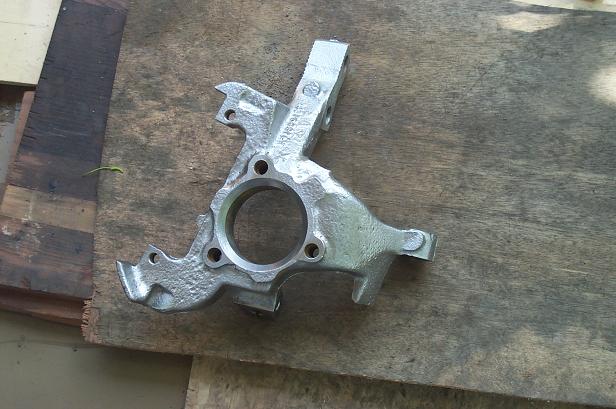

Here is a pic of the knuckel before I painted it.
It looked so good I almost didn't want to paint it.
It spent 1 day in a miratic acid bath then it was washed in water, dried in the oven for an hour at 200 then wire wheeled to get the surface rust off, hung and sprayed original GM grey metalic

I used 2 gallons acid and 1 gallon water after I discovered the vapor cloud from straigh acid was killing the neighbors grass... and trees and peeling the paint off the garage walls

Hey Rich, I diluted the acid just a little with water. It really does cause a cloud of noxious fumes. I usually dip it for no more than needed. I'll check the part every few minutes until I'm satisfied.
I would glass or even rice bead my parts but acid costs about 4 bucks for 2 gallons, the air compressor is 500+ not to mention the electric. The result would be about the same. The acid does get into EVEY nook and cranny.
One drawback to the acid is it will etch the metal. You want to remove as much paint and grease before using it. The results can be stunning, just look at that knuckel pic above.

Oh and do not even try to put aluminum in the acid, you will end up with a volcanic activity and there will be little left of the aluminum part.
