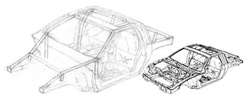

Looks like a good point to insert what the current goals are for the car:
    *Target weight
    2000-2250lbs (with me onboard)
    *Distribution
    slight rearward bias (maybe 45/55%)
    *Space Frame
    seam welded, reinforced with 12pt NHRA/SCCA certified roll cage, eventually detailed and powdercoated
    *Suspension
    Unequal length tubular or alloy A-arms w/fully adjustable coilover shocks front and rear, custom tubular front crossmember, custom tubular rear cradle (solid mount no bushings), poly suspension bushings throughout
    *Body
    All custom fiberglass fastback GT style bodywork, eventually carbon fiber (cf). Front clip is one piece unit, possibly with a small hinged or lift out panel for exhibition purposes. Rear clip is probably going to be a one piece upper unit with plastic Ferrari style window. Rear fascia ("bumper") and lower front quarter sections will be similar to original pieces. Doors will be fiberglass (eventually cf) copies, with trick hinges (not Lambo style).
    *Aerodynamics
    Full belly pan (sealed engine compartment). I am going to get fresh, clean, cool air to the back from the openings in the front fascia. All exterior body panels will be subtly smoothed and refined. No pockets and crevices, no pop up lights, as few seams as possible.
    *Powertrain
    Not sure what will be in it to begin actual testing and development, but the final result will most likely be a high-winding, fully polished Northstar. I like CHRFAB's "spider" intake, but I will probably do my own valve covers and top cover. I plan to run the Holley Commander ECU.
    No formal decision on the tranmission yet. A paddle-shifted full-manual automatic sounds like it fits the overall theme. Could start with the 4T60 GM 4spd, and keep my eye on that new 6spd auto GM and Ford and developing jointly.
    *Interior
    It will be sparse through most of the development stages, but the final result will be leather, carbon fiber, and aluminum, in the maze of powdercoated tubing.
That's what I am thinking so far.

Originally posted by perkidelic:
Are there any inherent weaknesses in our chassis, speaking mainly of the space frame as suspensions can be changed and developed. Can these weaknesses be remedied without essentially recreating the wheel (whole car)?
As with any production car, the biggest downfall for rigidity is the huge gaps required for the passenger compartment, doors, and windows. Gerald at www.8shark.com removed the doors and welded some tubes into the chassis in their place. I'm sure this helps a lot, but there are a few more places you could add bracing that would further add rigidity. If you haven't, you should go through his whole website, as he's breaking a lot of new Fiero ground sharing his progress along the way, and has some interesting ideas (his project isn't all that different from yours, except that it's dedicated to autocrossing). After reading the books by Aird, Adams, and Van Valkenburgh on race car chassis, it'll become more clearly what is desirable. Too much to explain here, and it also depends on what you want for passenger space and creature comforts.

I have refrained from sticking a lot of pics in this thread because it naturally evolved as a text-format think tank, but this is the best way to show you where I am headed. I have soooo much work to do on this drawing and there are tons of errors in it, so please ignore them and hopefully it'll give you an idea of what will be at the core of my car...
You should be able to see clearly where the majority of my weight reduction will come from (in the space frame). Main front and rear frame rails remain, but all the upper structure is replaced with the cage. There will be diagonal door bars running from the upper rear corner (middle of rear hoop) to the lower front corner (bottom of front hoop). Doors themselves will be fiberglass (eventually carbon fiber - "cf") copies.
Passenger compartment is pretty much intact - that's the part of the Fiero that most directly affects what you experience and I want to preserve some of that.
Cover this with fiberglass body panels (eventually cf), lighter suspension, comparable powertrain, lighter interior, and it doesn't add up to much.
The best way I can describe my interior is a rough and ready race car with "soft skin". Fiberglass (possibly cf) panels skinned with really thin animal hides will cover most surfaces. Looking for something different for the floors than traditional carpet. Aluminum everywhere possible as opposed to steel. How about we call it "cosmetic covers" Basically what I am after is an interior that resembles a production car interior, but is as light as possible. Not overly worried about sound control, etc. This is a purpose built car, and I want the driving experience to fit that purpose. If I can get it to the point where it never lets you forget what you're in, but doesn't wear you out in an hour, I'll be happy. Maybe kind of motorcyclish - a man and machine kind of thing.
