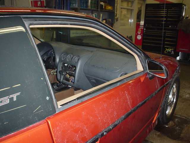

The dash position is 4 inches from the end corners of dash to windshield and just over 7 inches from the direction change (corner)in middle of dash to windshield.
mrfixit58
Posts: 3330
From: Seffner, Fl, USA
Registered: Jul 99
Total ratings: 113
Report this Post01-11-2003 09:25 AM Click Here to See the Profile for mrfixit58Send a Private Message to mrfixit58Direct Link to This Post
Originally posted by PBJ:
Our filler pannel between dash and windshield is being held there right now by gravity. I plan on holding it down by appoxying an eyelit in several places and with the use of small elastic cords down to an accessable area under the dash to be able to remove easily.
THe factory filler was held in place by "D" lock from the factory. That's kinda like velcro but has a holding strength of 40 #/in^2. If you look at the two top center supports you should see the reminents. You could buy some more and mount it the same way. I think I've seen it at Home Depot. Anyway, that's what I used even on my home-made filler.
PJB -- I'm curious about the factory filler. Does the hump behind the cluster stick above the VIN plate?

Report this Post01-11-2003 09:54 AM Click Here to See the Profile for PBJSend a Private Message to PBJDirect Link to This Post
Roy
No the vin plate shows as factory, I had to do a bit of knotch, but you can not see that.
Pete

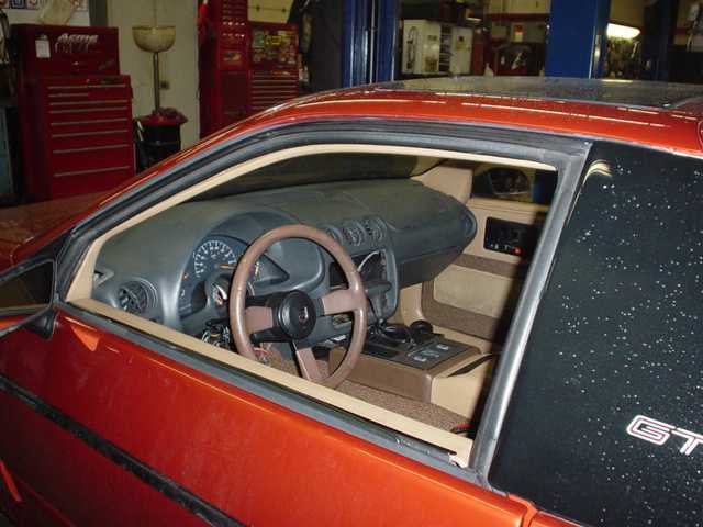

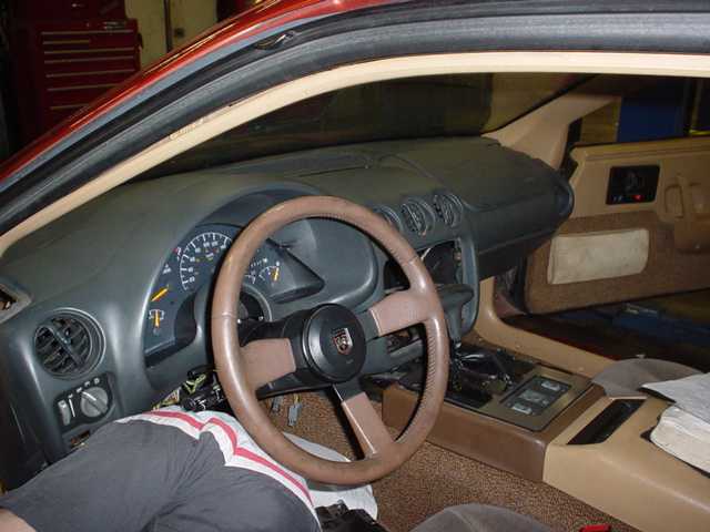

Well, believe it or not, there's not a lot of differences between the Fiero and the Firebird steering column. Both are round with two levers. The difference is the length (the Fiero column is shorter). The difference in looks mostly comes from the steering wheel. If you look at a stock Firebird or Camaro, you'll see what I mean. I will admit that it would clean up another detail if I were to shorten my steering column about 2".
Roy
I guess the steering wheel just looks weird behind the tublar shaft. Maybe the firebirds sit further back in the dash or the thickness helps ease the transistion.

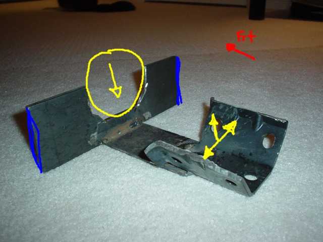

Report this Post01-13-2003 06:06 PM Click Here to See the Profile for Her86GTClick Here to visit Her86GT's HomePageSend a Private Message to Her86GTDirect Link to This Post

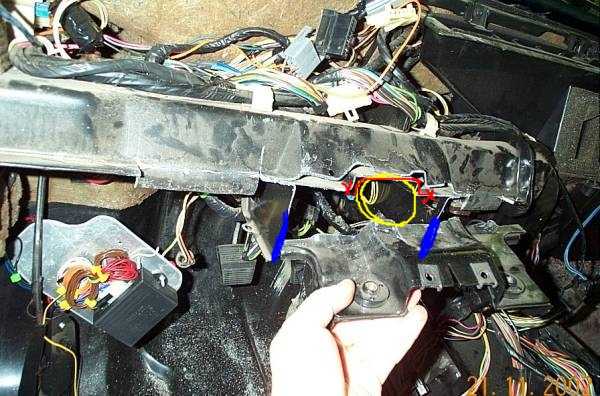

The new steering column bracket.
jscott1
Posts: 21676
From: Houston, TX , USA
Feedback score:    (15)
Total ratings: 415
Report this Post01-13-2003 06:14 PM Click Here to See the Profile for jscott1Send a Private Message to jscott1Direct Link to This Post
Can you explain how that's installed?
baldlobo
Posts: 743
From: WPG,MB,Canada
Registered: Jul 2000
Report this Post01-13-2003 08:59 PM Click Here to See the Profile for baldloboSend a Private Message to baldloboDirect Link to This Post
Originally posted by Her86GT:
A few more of tonight's progress:
the auto stick looks close to the center of the dash. you might want to go searching for a first gen cav shifter(it's bent back maybe 15 degrees)
PBJ
Posts: 4167
From: London, On., Canada
Total ratings: 147
Report this Post01-13-2003 09:18 PM Click Here to See the Profile for PBJSend a Private Message to PBJDirect Link to This Post
This is how I "plan" on installing this bracket, we shall see though
Yellow is steering column
blue is to be mig welded
red is further removed metal
Hope this is understandable, never was good with words.
Pete
