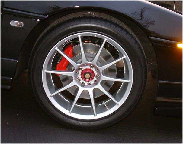

I used the 1200 degree paint and it worked just fine. A year later it looks just like it did when I first painted it on. The paint that I used didn't say anything about baking it on.
By the way I used 500 degree on the rotors and it started flaking off almost immediately. Draw your own conclusions from that.
By the way these are 88 brakes so they are cast iron surface.

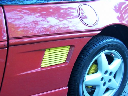

I used the Dupli-color 1200 degree high heat with ceramic engine paint. True it's not shiny, but it looks way better than brown rusty ole calipers. It goes on real thick and I doubt it's going to flake off any time soon. the 500 degree is like water color by comparison.
And if you notice I only painted the front half of the caliper, because I split it in half, then took the front half in the house and scrubbed it real good with lots of degreasers and soap and steel wool. That way I didn't have to touch th hydraulic line and bleed the brakes.

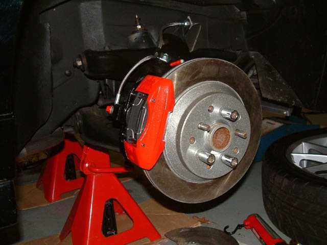

I used 900* high durability Brake Caliper paint (not that sig pic is before i did this, hence calpers are not blue there"

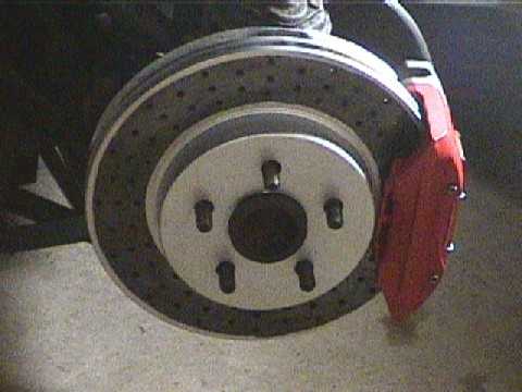

Well this will through you a curve, I used a special paint that is used in the sign industry (lead base) so it will hold up to heat but I'm now running Porterfield Racing/Street pads all the way around and they will not get hot so that may help with the heat issue.. and to draw you own conclusions this is what kind of heat it has withstood so far.. In order to brake in the pads I was told by to good sources to drag the brake for a little while, then to get on them really hard to seat them in.. So I said OK... and did just that... well the Corvette rotors got so hot it BURNT of the powdercoating on the outter edge of the rotor but the calibers still look great... here's a pic of the finished job before break-in
and this is after the brake in...
I did mine in two different colors, Black for the back of the calipers and red for the front.. This was cheaper than powdercoating if it continues to hold up and if not "then" I will go that route.. but I used this on the engine in my truck and it has held up there too .. "One Shot-Lettering Enamel" This is usually only sold to those in the industry but if your friends with someone who owns a paint store you may be able to try it yourself..

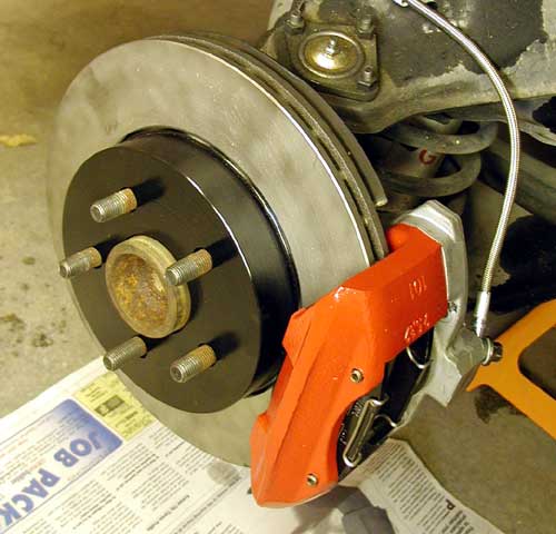

I painted the calipers on my '88 Formula using VHT brand 900 degree "Hi-Temp Brake Paint." VHT has been making high-temperature specialty paints for over 35 years and I've had good results with them in other applications. See www.pjhbrands.com/vht/. I bought the brake paint from Jegs Racing (www.jegs.com), but I have since seen it at AutoZone for about the same price. This paint requires mild oven curing ... 250 F for at least 30 minutes. Oven curing is good.
As you can see in the pic above, I split the caliper assemblies and painted just the cast steel bridges, leaving the caliper bodies natural aluminum. The bridges are about all you can see when the wheels are mounted anyway.
I used gloss red on the caliper bridges and gloss black on the rotor hats. I know you normally can't see the rotor hats, but I painted them inside and out mainly as a rust-preventive measure. Besides, my wife and I have a saying: "Anything worth doing is worth overdoing!"
As with most painting projects, good results depend more on good preparation than just about anything else. I cleaned and lightly bead blasted all parts before painting, although you could obtain similar results with a ScotchBrite pad if you don't have access to a bead blast cabinet. I also masked off the mating surfaces where the bridge meets the caliper body, as well as the pad bearing surfaces, before painting.
The black paint covered well with one coat and was easy to apply, but the red took three coats and was a lot harder to work with. It's possible that I was being too cautious with the red, but there just didn't seem to be as much pigment in the paint as I expected. As usual, several thin coats applied at 20 minute intervals are better than one thick coat. I allowed the parts to air dry overnight, oven cured them the next morning at 250 F for 30 minutes per VHT's instructions, and didn't install them until they had slowly cooled back down to room temperature. ALWAYS use a torque wrench (74 ft-lbs) on the two large bolts when you reassemble the bridge to the caliper body!!!
Overall, I'm pleased with the results ... but only time will tell how the paint will hold up in service.
