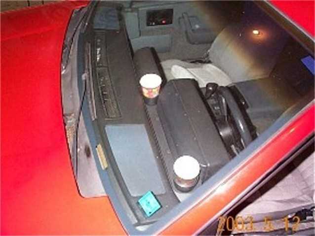

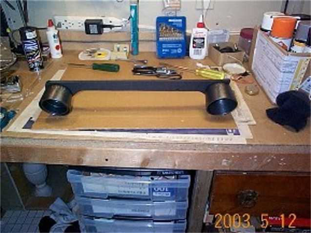

Well, I suspect many of you are weary of custom cupholder designs, but allow me to share my creation with you. I have only been on the Forum for a little over a year, so forgive me if someone has already posted this arrangement.

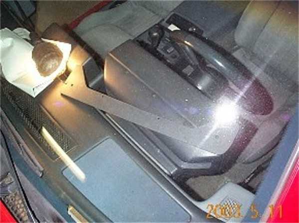

I made a template and then used a jigsaw to cut a rigid plastic plate that would fit in the space behind the insturment panel, like this:

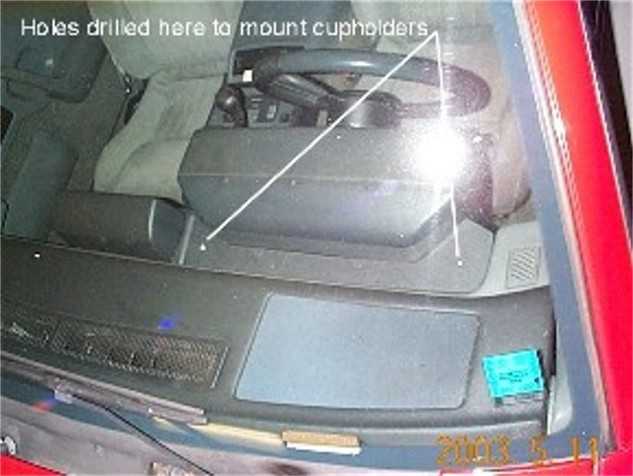

It looks a bit like a stretched-out boomerang. It will be fastened down by removing the two screws behind the instrument panel, and replacing them with longer ones. Here is a pic with the plate in position:

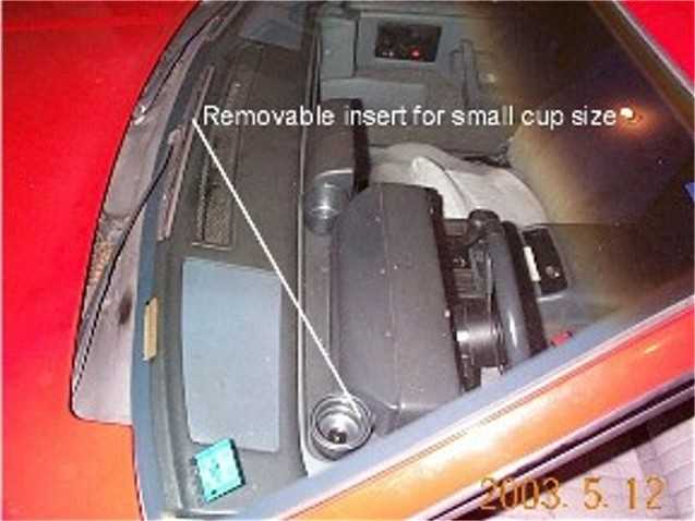

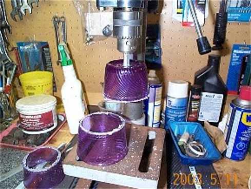

Now, the actual cupholders were made from a couple of large plastic glasses that had the proper taper angle for a Tim Hortons cup (I know, I know, only us Canadians know what a Tim Hortons cup is). Anyway, my wife doesn't know this yet, but I sacrificed two of her patio glasses. I drilled a hole in the bottom of the glass, fastened in my drill press, and used a hack saw blade to cut it to the proper height. This was the setup:
Next, I mounted the cups on the end of the plate and used a charcoal-grey spray paint to match the dash color.
Then, fasten the assembly into position
This is what it finally looks like. Canadian forum members will appreciate the perfect fit for a Tim Hortons cup. Actually, the left one has a removable insert, so you can switch between a small or medium cup size.

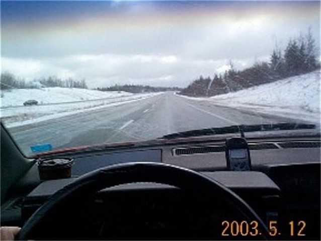

Finally, an added benefit is that you can use one of the holders for your cell phone.
Yes, that is snow on the ground!! The pic was taken near Amherst, Nova Scotia, while I was delivering my '88GT to jelly2m8, so he could do some work on it for me.
Hope this was of interest to some of you. Any comments?

Those are pretty cool.
Also neat how you took those pictures a month from now. I hope you enjoy the cupholders when you get them done!

Ooooops.....That digital camera was set one month ahead. That should be April, not May, folks..

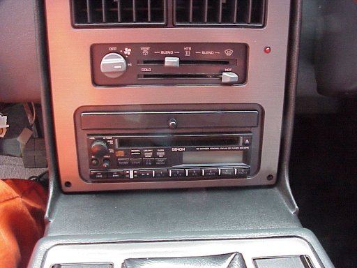

That's a good idea. My setup only works if you've installed a 1 DIN stereo.

Hey Fierosound, that looks pretty good. Which DIN stero system are you using? And, are those cupholders built into the system, or something you added afterwards?

It's the Denon unit I've had "forever". I built a new mounting plate and moved it lower in the 1.5 DIN hole.
I got the cupholder from a 96 Dolt Colt at the wrecker.
