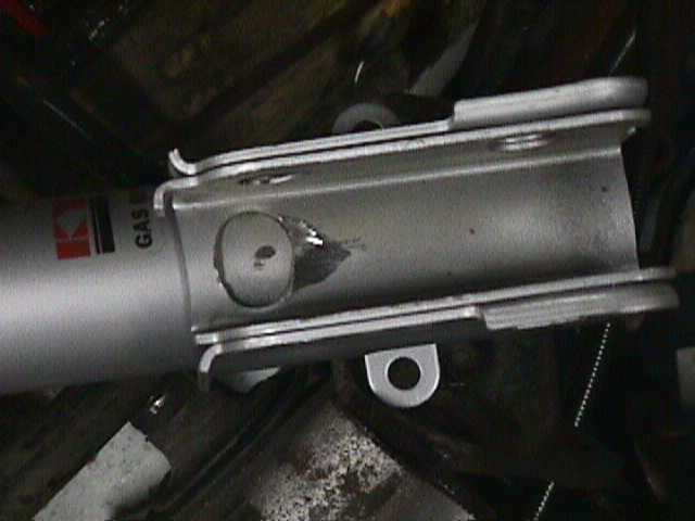

If you are looking at KYB GR-2s, use the same rear strut listed for 85-87 Fieros. (That's what the Fiero Store would sell you.) Some have reported slight interference that required a little grinding on the right rear knuckle, but my '88 Formula did not. I like the KYBs on my Fiero.

I have the KYB GR-2 struts on the back of my 88 Formula and love them! (Gas-A-Just up front). I did have to grind mine slightly for clearance, but it's not much at all.

I put the GR2's on the back of my 88 and did run into the interference fit that Formula88 mentioned.
I didn't remove material from the strut, I removed a tiny amount from the back of the knuckle. Won't ever have to worry about that problem again when I replace the struts.

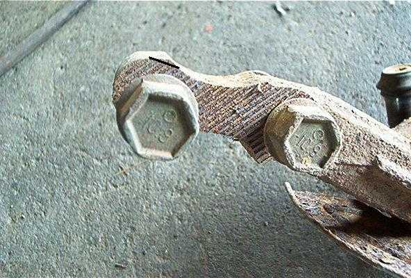

How about showing us now. I just ordered a set of KYB struts last night and would like to know where this knuckle material should be removed.
Look at the pic I posted. When you put the strut up to the knuckle, you'll see where this area will touch (if it touches). It's a pointed part of the knuckle. Just flatten off the point some.
