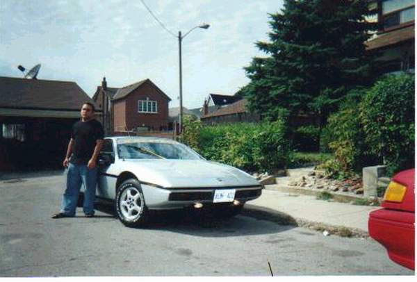

The reason I have a 4 banger is cuz when I bought my fiero I really didn't know what a fiero was.
What I really wanted was a Trans Am, But I didn't like the fact that the Trans Am was so big and long. so my brother told me that one of his friends brothers was selling a fiero, which he told me was like a smaller version of the trans am.
Hell when I bought the car I didn't even know the engine was in the back till' I got it home.
It wasn't till I was told about the forum, that I really got into fieros and made this...
Into this....
And the best is still to come

hmmm, so you just added that front end? I never knew it started out with that kinda nose(whats the technical name for it?)
you should post a buildup of it

all im saying tabs you are the s#!t, How you can change a ugly car like that and turn it into a work of art is unreal my own opinion you have the badest ass nothback and skitime has the badest ass speedback i also have a 85 duke put gt bumper on

While we're on it.. Tabs, I must also agree that my car looks as good as yours when its outta the paint shop. I mean, theres nothing very drastic about the car, but yet it just looks soo clean and sleek.. Maybe its the color? the Wheels? Idunno..
It DOES look good!
It DOES look good!
I think it's Both the wheels & the color! A very nice ride in any case!
