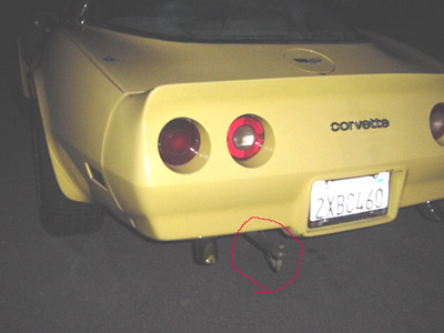

The one on my Vette is mounted sort of like yours, Frank. Not really off the trailer hitch but down low under the rear of the car. The matching yellow antenna is not attached in this picture but you can see where it goes. You can actually swing the mount out of site under the car when the antenna is off.

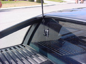

This is my installation, along with a Radio Shack thru the glass antenna it works fine for traveling the highways.

Phil's installation looks good. I decided that location wouldn't work for me, because I like convenient access to the front of the radio, and that's kind of a far reach. Also, my mic cord is on the right side of the unit, and it's harder to see the LCD display over there.
