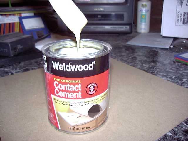

I keep telling you all but nobody listens. Those spray cans arent worth it. Ill ONLY use Weldwood Contact Cement from any hardware store. It went up now to $4 a pint, which is enough for a headliner. Coat both surfaces and wait a few mins then stick it. Make SURE you use the can that says 'Original" and not the new 'non'flammable' one (its white and not worth a crap). Make sure you got it placed rite because your not going to ever get it back off ever. If you use it and your headliner falls down before you sell your car, ill redo it free for you. Ive got black Naugahyde (heavy) in the Ferraro, and its been there for years. You will destroy the ceiling panel if you try to pull it loose. I use it straight out of the can in my paint gun, but it can be rolled on too. Dont use a thick layer, just enough to cover.

spraying is by far better than the roller. If you want to change it now, you either have to buy a new back board or do what ive done...just put the new one over the top of the one you have. Just makes extra padding.
If it came back off or bubbled, you either got it on too thick or didnt let it dry long enough before sticking them together. The glue CANT be wet.

I just went to Home Depot and got that pint last week for $4.39. Did Raptor headliner w/no sunroof and the whole back compartment carpet in the Corvette coupe (floor,2 rear wheel houses,rear panel). And still got some left.
I know several people that own auto upholstery shops and they all buy bulk contact cement and use a paint gun. Only time I see a spray can around is for something like fixing a sunvisor.
