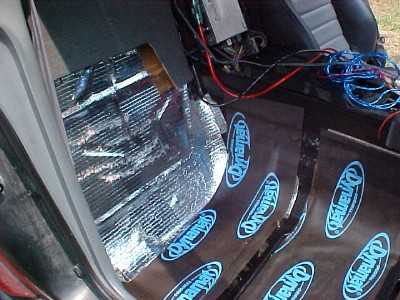

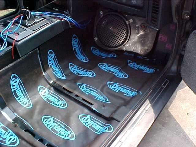

I've only used Dynamat and Metra brand deadener. Of the two I prefer the Dynamat. It does leave a bit of a tar smell for a couple weeks, but it seems to install easier, feels heavier, and more durable. I used both brands in my Fiero. I would really suggest getting Dynamat sound deadener with the metallic heat barrier. It really keeps the heat from coming through the firewall. You can see the metallic deadener in the pics.
