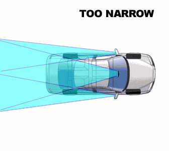

You can eliminate your blind spot by adjusting your side mirrors properly.
Most people adjust them in a way that gives too narrow a field of view.
Exterior rearview mirrors - As for the side view mirror or mirrors, most people adjust them so they can see the side of the car on the inside edge of the mirror. If you adjust your mirrors using that criteria, are you aware of the huge blind spots that you've created? (Now is the time to take another look at the animated diagram at the top of the page.) Consider the view when the side view mirrors are set up as just described. Essentially, you have created "tunnel vision" to the rear. Your side view mirrors overlap much of what your inside rearview mirrors sees and you've also created blind spots. What in the solution to tunnel vision and blind spots? Simply adjust the side view mirrors just beyond the point where you could see the side of the car on the inside edge of the mirror. With this setup, you almost completely solve the blind spot problem. It takes a little while to get used to, but it is an improvement. Some quick tips: For the driver's side mirror: Place the side of your head against the window, then adjust the mirror until the side of your vehicle comes into view. For the passenger's side mirror: While sitting in the driver's seat, lean to the right so that your head is in the car's centerline. Adjust the mirror until the side of your vehicle comes into view.
Go here for more information http://www.smartmotorist.com/mir/mir.htm
I've been adjusting my mirrors this way after reading about it years ago, and have no blind spot problem at all in my GT. As a vehicle starts to be disappear in the rear view, it starts to appear in the side mirror. You also won't be blinded by headlights shining in your side mirrors anymore. Works great!!

very informative. i've been adjusting mine this way all my life, just because it makes the most sense. thanks for the animation it makes it easy for lazy people like me to get the point without reading.

So that's how they work......
Ok, it's a good graphic and makes the point. I assume that most cars aren't 2 feet wide so I adjust them out a bit to fill in the big hole. If you're on a bike, well, it might hurt.

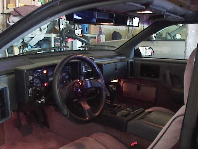

What blind spots? I have almost 360 degrees of vision in my car with my setup. I hardly ever use the side mirrors with this. Good article by the way. I have my daily driver set up as you descrive.
