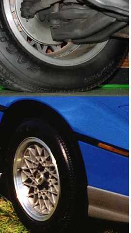

Well, lets see,
My 87 GT still has it's Factory tires still on.
They are Goodyear Eagle GT
Front: 205 / 60 15
Rear: 215 / 60 15
www.centralfloridafieros.com/Coolblue87GT.htm
