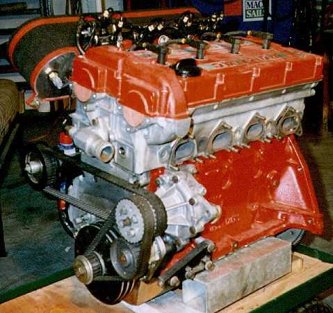

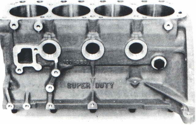

It was not a production 2.5L, It was a specially designed racing engine called the Super Duty 4 (SD4) The engine was designed and sold by Pontiac. The Fiero race cars had them. Kansas Race Products now sells the SD4 engines. These engines were capable of huge horsepower. The Rod Shop had a drag race car that put out 520hp! Do a search for "Pontiac SD4" on a search engine and you'll find out more info.

There are also a few used engines for sale. Expensive, but they can be found. When I was looking a few years ago, I found 2 for sale. One was 230hp for $6500 and the other was 275hp for $8000.
