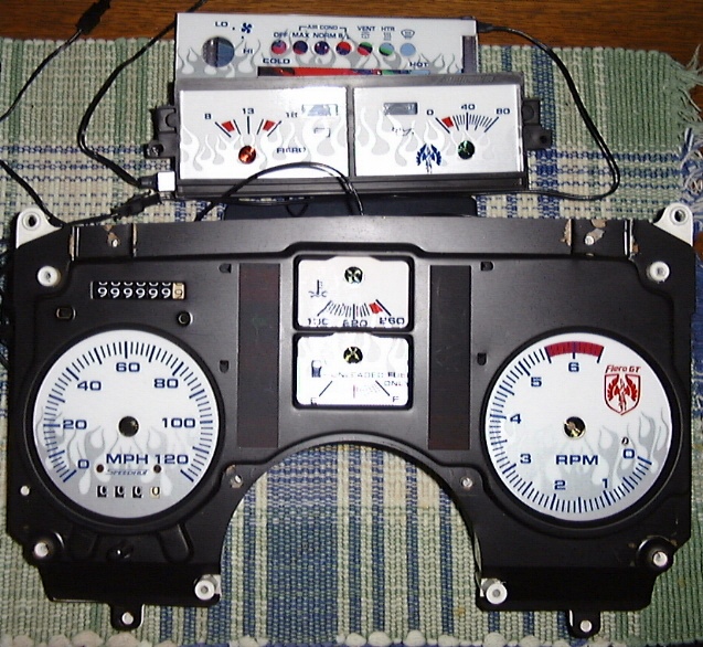

And here's the first pics of my gauges! And yes, I know my camera sucks.
#1
#2
#3
#4
#5
EDIT: Changed to links for you 56k peoples

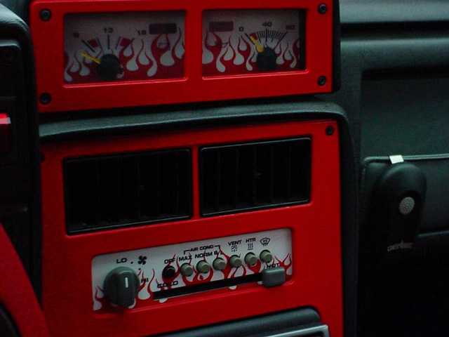

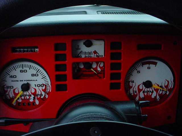

Here's pics of my gauges installed. I love the way they look!
