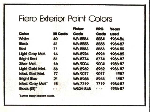

Does anyone know the code, or where i could find the paint code for my fiero. Its a white 85gt. Thanks

www.centralfloridafieros.com/Coolblue87GT.htm

you are the man!!

If you wanna verify it. open front hood, on driver side fender well is a white label about 3X5 inches with all the code numbers of components. the last number at bottom is the color of yours. In your case it should say WA-8554
