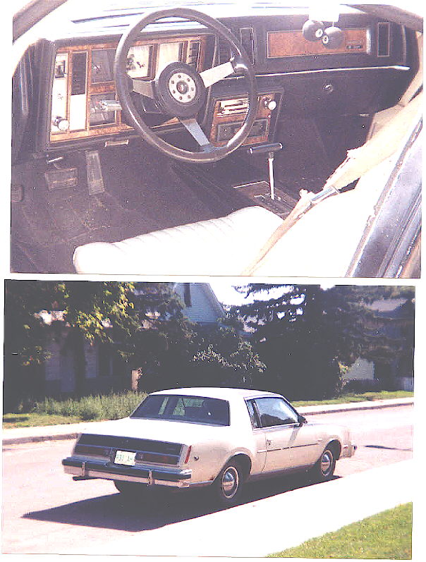

Wow that is one fast car! Hey I would like to see some pics as you get things together I think this is the motor I will look for for my 85. I plan on switching the manual 4 speed to a auto. That way I can build boost witout frying a clutch! I wount go as hig as you looking for around 13's at 350 hp. That way it is still reliable for cruising. Do you plan on using a intercooler? Any idea where to mount it? I have a 80 Sport Coupe but it is missing the turbo motor has a 305 But I can see why people like these cars. Heres a pic
