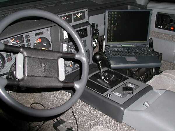

I have been trying to get some more HP out of my setup. Aside of adding more expensive hardware (coming up this winter BTW), I figure some gains could be achieved by means of software.
In 1994 GM upgraded LT1 engines EPROMS to EEPROMS, thus giving the ECM the ability
to be reprogrammed on the fly.
So, with that in mind, this is what I have playing with lately...
And the data acquisition application...

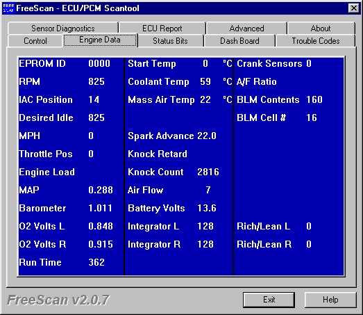

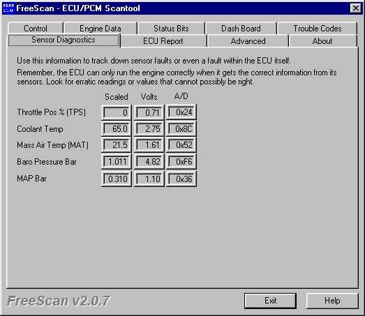

This is a nifty little application called FreeScan. It allows for real-time monitoring
of ECM parameters and a little modification of some of them.
The main purpose for this is to capture a binary file with this data so it can be sent out to someone with more knowledge in LT1 diagnostics and that can tweak the ECM better and hopefully give the LT1 a few more horsepower.
Some of the most useful screens...

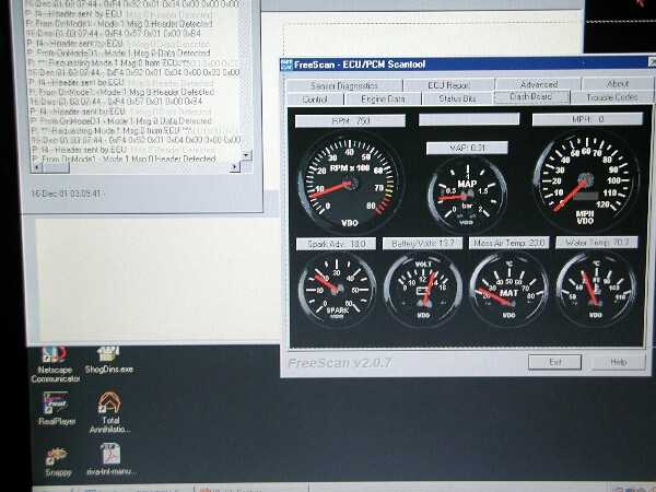

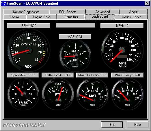

Yeap, those are VDO lookalike gauges!
These parameters get updated several times per second.

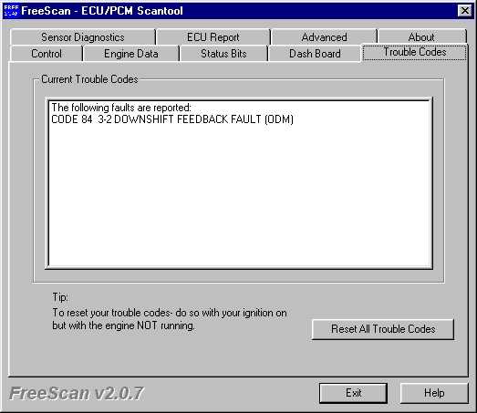

You can also check and clear error codes here. This one is one that does not worry me at all.
It is pretty cool to see the way the ECM "Thinks", as is controlling the LT1. This
is specially usefull at WOT. Next is to take this same setup back to the Dyno so I can get a baseline before FieroLT1 gets another 100 extra horsepower worth of new hardware.
