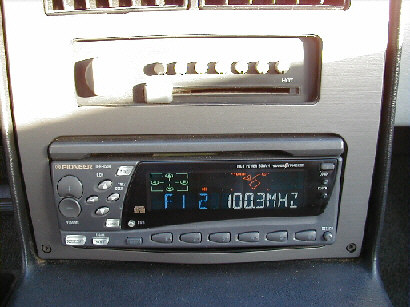

I'm a "bit" of an audiophile and I want to load my Fiero with some nice stuff, post you specs and pics of your car/ideas to get my inspiration going
I've bought a spanking new Pioneer headunit yesterday:
With MP3 so I don;t need my CD-changer anymore, saves some precious space
I have a Rodek 6 channel amp lying around so I want to use that for 4x10cm in the dash and a sub, the radio for the headrest speakers.
Building the sub and amp behind the seats is out of the question... I thinking of building a case under the dash with a 10" sub and the amp in the trunk.
Any help/hints and most of all pics and specs?

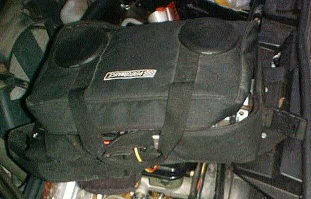

Right now it is sitting in the passenger foot space, it is strapped to the center console and my wife still has enough room to put her feet. I would like to buy / build a cabinet that sits under the dash on the passenger side but it works for now.

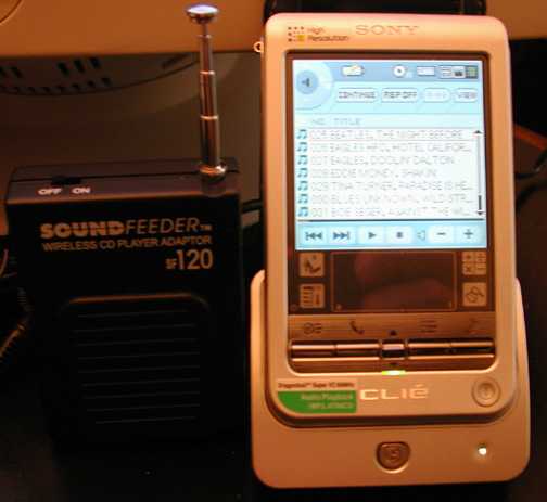

My pocket computer is my MP3 player, works everywhere, you just need an FM receiver, or put the headphones on. Needed it for work, so it doubles for playing mp3 through home stereo, cars, etc, etc.
[I MG]https://www.fiero.nl/uploads/imgs2003/clie.jpg[/IMG]
Nice but I was planning for a bit more Watts than a headphone

The only watts you need is in your car radio, or tuner amp, the little black box is putting out an FM Stereo Radio signal.

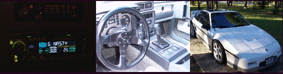

Report this Post09-22-2002 06:46 PM Click Here to See the Profile for G-NastyClick Here to visit G-Nasty's HomePageSend a Private Message to G-NastyDirect Link to This Post
Pioneer DEH-P47DH (d-face) w/ remote
Factory Sub bass & amp w/ console
Alpine 4X10 strontium
Rockford FG 4X6
I burn all my mp3s on a CD-R.
Seems everyone I know hates radio so no wonder people are putting mp3 players in thier cars. One of my friends is getting satelite radio soon. It is suppossed to have large selection of stations & music.
Im looking into gettig 8" subs behind seats because my exhaust is too loud.

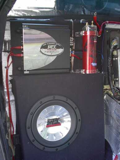

Report this Post09-23-2002 01:36 AM Click Here to See the Profile for Wheels1Click Here to visit Wheels1's HomePageSend a Private Message to Wheels1Direct Link to This Post

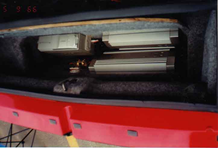

Here's a link to my car & system... https://www.fiero.nl/forum/Forum1/HTML/020824.html

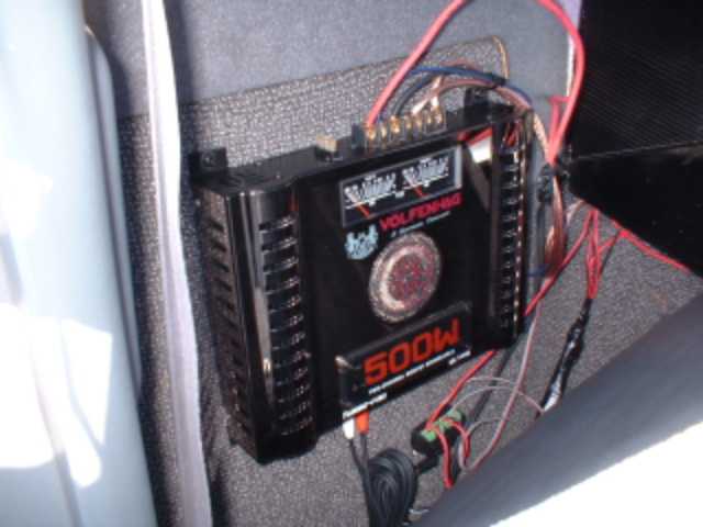

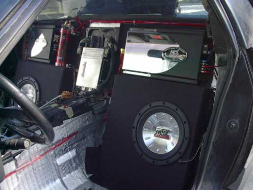

If you have any ?? please ask..Oh here is a pic of a 1800 watt sys I'm finishing up on now....

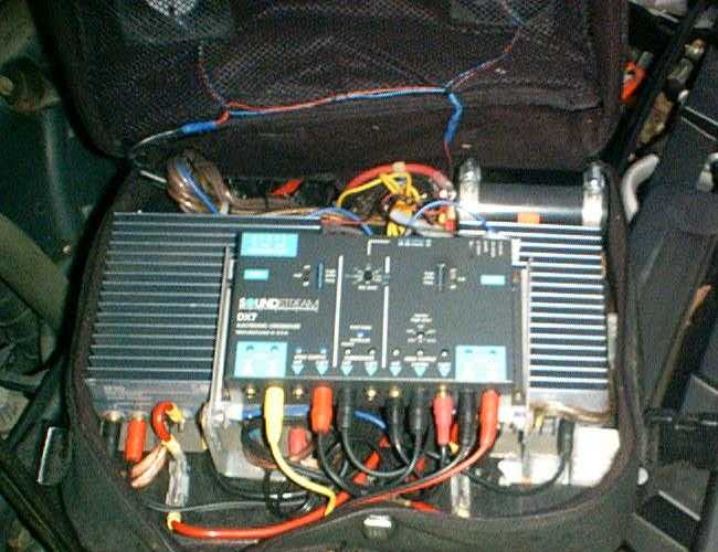

My pics:
https://www.fiero.nl/uploads/amp_wiring_and_location.jpg
https://www.fiero.nl/uploads/sub_box_and_ecm_location.jpg
I haven't had time to make a console yet, but it's way up on my list of things to do (although, the new wrist pin knock is at #1 ).

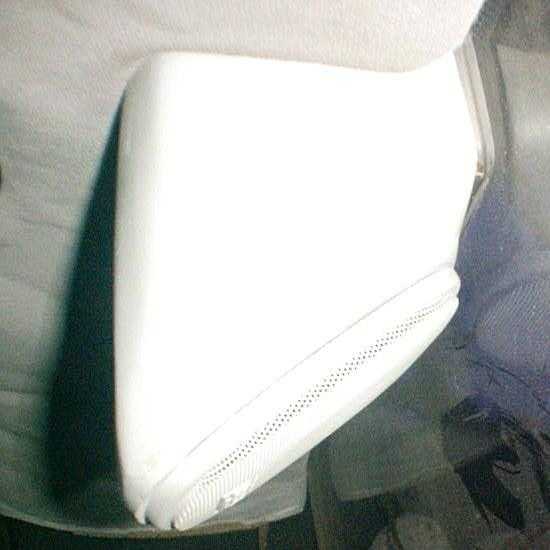

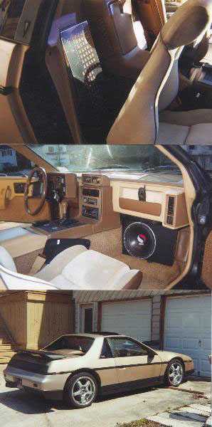

Report this Post09-23-2002 09:24 AM Click Here to See the Profile for AkursedXSend a Private Message to AkursedXDirect Link to This Post

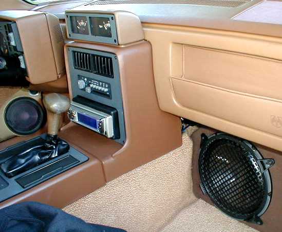

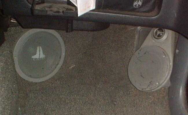

That's just a pic of the sub and headunit. Oh and you can see my speaker pods in it too.
Here's a list of what I got.
-Panasonic 60x4 LCD headunit
-Kenwood Excelon 500 watt amp for the sub
-MTX 300 watt amp for my speaker pods
-Kenwood 4" components in the front dash
-Blaupunkt overdrive 4x6's in the rear
-Kenwood Excelon 6.5" components in the speaker pods
-Pioneer Premier 10" DVC subwoofer in the footwell
-Lightning Audio 1 farad capacitor

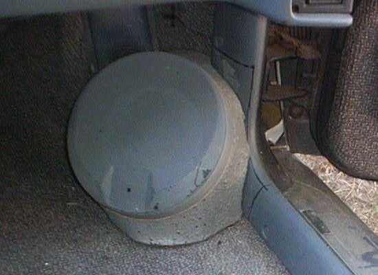

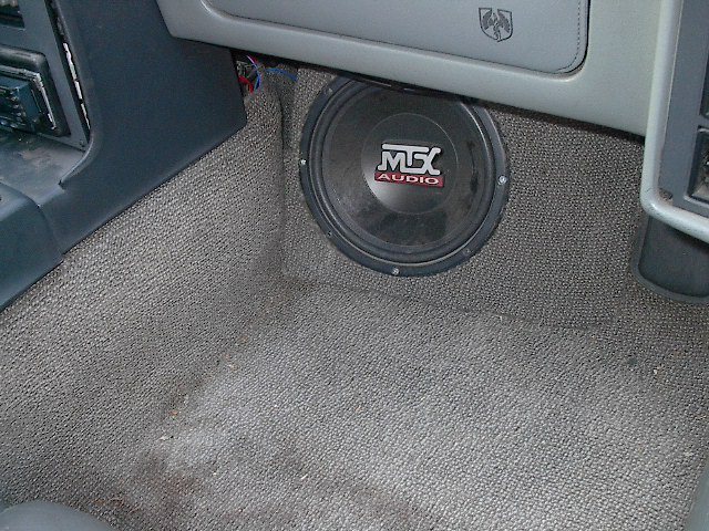

OK I got it to work, heres my sub set-up. Its only an 8" and charlie made it. The box is fantastic. A little pricy, but well worth it.
Sorry about the mats, I have originals, but they are hard to comebye apparently, so i made these out of old carpet

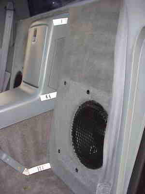

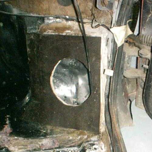

Report this Post09-23-2002 09:20 PM Click Here to See the Profile for fierosoundClick Here to visit fierosound's HomePageSend a Private Message to fierosoundDirect Link to This Post
Originally posted by cstricker:
where the box went all the way to the lip just behind the headrest so you get more volume out of the box without having to cut out the firewall?

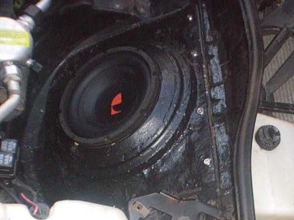

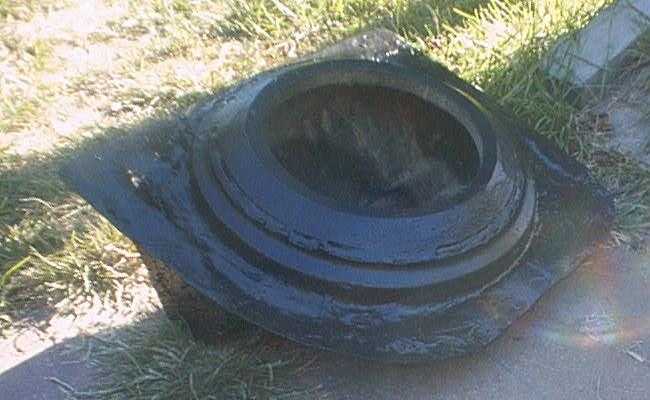

My sub boxes go from the floor to the top of the firewall. Cutting the firewall is done more for reducing the depth of the box, than for getting volume. It's a trade-off based on how much legroom you are willing to lose.
You can see the placement of the sub boxes relative to the center console and side panel. At location I & II it is 3 inches from the FRONT of the console to the front of the sub-box. At location III it is 4 1/2 inches from the bolt center to the front of the sub-box. In the second photo you can see where the front of the sub box is relative to the seat belts on the side panels.
How deep your subwoofers are will determine how deep the boxes will need to be, regardless of whether you cut into the firewall or not. I've done some more research and have found that some shallow depth subs are now made. These are high-end high Sound Quality subs. Be warned, you won't find these on sale at WalMart!!

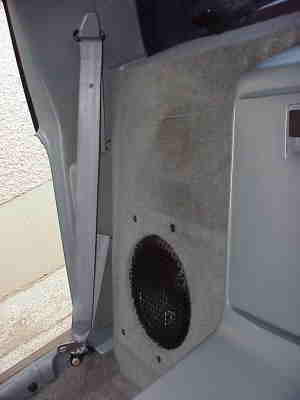

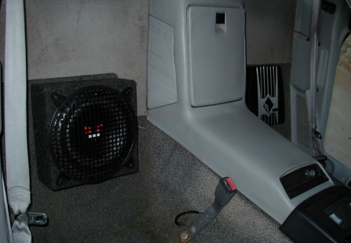

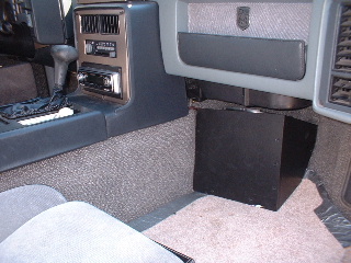

Wow, some of you folks have some nice stereos. I opted for a budget system with a Pioneer 1.5 DIN CD deck, Pioneer 4X10 coaxial front speakers, factory headrest speakers (mainly just for a little rear fill).
Here's a pic with the seats out. I have a small 100 watt Rockford Fosgate Punch amp behind the driver's seat and a very small box with 8" Rockford Fosgate Punch sub behind the passenger's seat to blend in some extra bass.

Chris, Here is a pic of my install.... The BLUE X is the amp mounted on the firewall, the RED X is the back board only covered in a diff. material Same Size as before, & the YELLOW X is the center con. It is in the same place as before. Note the PURPLE is how far the box is out from the firewall. 2 & 3/4" The seat bottom is about 4 1/2" from the firewall, With the bottom of the seat all the way back you still have over 2" of space.. You live in Ks. right? I'll be at the Ark. City show. I'll have my car & hopefully a car I'm doing now to show you. I can also help if you need it... LMK.... Thanks, Chris.
P.S. We can just do the pass. side. It will still sound fine...

the only compleat (as a system of mine gets) fiero system i had was partially stolen so here are a bunch of mainly unrelated ideas from different fieros.
my '87 coupe i've had longest. this is a 5.25" coustic component set with an 8" jl audio in the pass. footwell. i'm suppossed to be switching this to 3-8" with one there and 1 in each door.

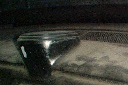

a 4" jensen in the center of the dash.
i might have got too close to tell what it is. the other 4" jensen in a pod that is par of my third brake light. i keep it turned down really low 'cause i never worked out the delay on it i wanted.
the head and eq were stolen but here are the amps...
thought it would be good to be able to take them out for security and to get to the spare. old computer bag with two fans added. no cooling probs ever.
real low power and old soundstream stuff. x-over gives me center out and added a cap 'cause i could .5 farad.

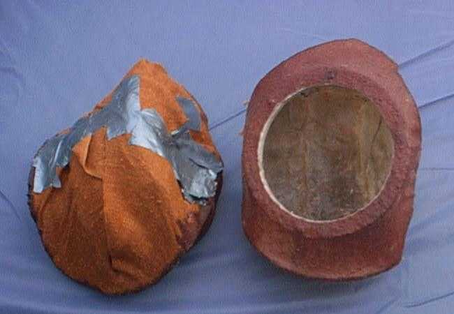

the rest is unfinished stuff. more or less in the order i've been working on them.
8" infinity 813i's right now hooked strait to a pioneer head. this is supposed to be my eventual big system (with 2 10"s, fierosound style and seat speakers. planning on about 500watts).
experiment. i want to get carpet without footpads and have the pods under it. this is for some 6.5" infinities.
another experiment. a 10" box that fits under the spare. still haven't figured out venting it to the passenger compartment. not hooked up yet either so i don't know how it sounds.
another 8" pod that's a little bigger to try and take more advantage of the size of the speaker. also bigger after i made the first and saw i could still get to fuses. i think unless you're a total basshead you could experiment and make the biggest possible pod and not need subs.
anyway that's all my stuff. hope there was an idea or two in there.

I bought my sub box from a forum member and am very happy with it. It does take up a little space in the footwell... but I don't sit over there so who cares?
