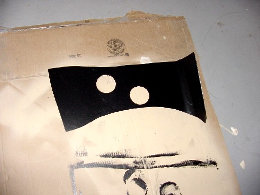

Well, here's one I found. I thought it was kind of funny. When the body shop ran it in the paint booth it had on seats so he put his little creeper chair in it to sit on.
I don't really have anything new to put up yet. The trunk piece has taken a lot more time than I expected,(so what's new there) and of course all the other little details are time eaters.

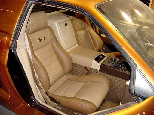

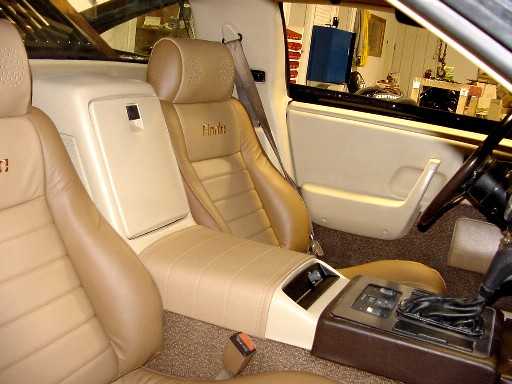

Well, we got the interior painted and cleaned and in yesterday and today. It looks like everything will be ready to go for pinstriping on Thursday as planned. Here are some pics of the new interior.
And another one, a little more detail
The color is a little lighter than original on the light tan, but not a whole lot and since all the plastic needed redone, we used it.

The interior was the least expensive part of the deal. $50 worth of vinyl paint. Mr. Mikes seat covers, saddle and visors, $35 worth or headliner material, which we also used to cover the rear area that has that fabric or horsehair or whatever the heck that stuff used to be. 8-)
We also covered the inside of the doors, firewall, and B pillar (inside) with Dynamat so that cost a little more money.

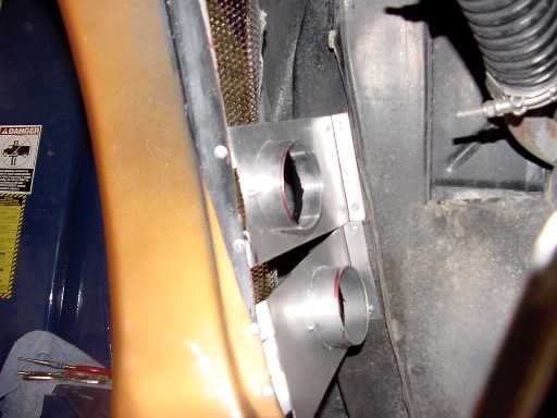

Today we worked on the air inlet for the engine air intake. We started by making a couple of brackets with the pieces for the Scat tubing and mounted them.
We have a plastic piece that will seal off the back, top, and most of the bottom.
It won't be a pressure tight seal, but the goal is to deliver cooler air than what's in the engine compartment to the air intake.

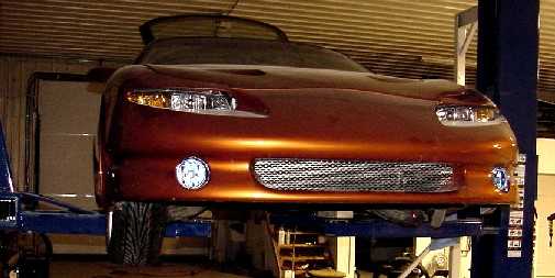

Here's a picture of the front end with the driving lights mounted and the front grill material installed.
The picture doesn't show the material very well, so here's a closer view. It's aluminum, 3/4" oval, from McMaster-Carr. I have enough to do about 3 or 4 more if I mess this one up.

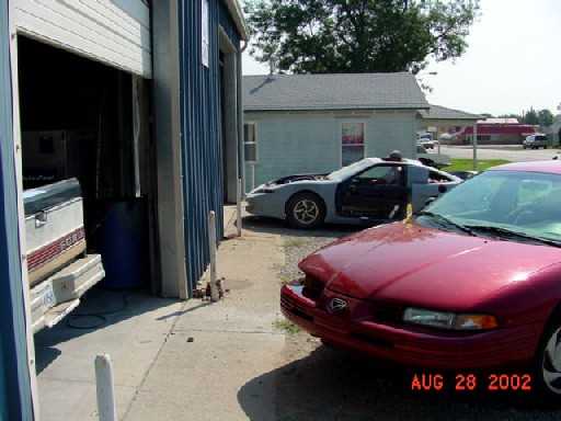

The maiden voyage of the good ship Finale was today. I had to take it about 35 miles to have it pinstriped and finish the exhaust.
We have the interior done and pretty much everything finished up except some tiny details.
I got to the muffler shop about 8:15 and the car sat in front of the shop for about 10 minutes while the tech rolled out the car that was on the lift. We took it inside and it's so low we had to push it on the lift by hand and the rockers still scraped slightly so it was half in and half out of the shop for another 5 minutes or so. Just started showing him how I wanted it done and a guy comes in with a tie and no jacket.
