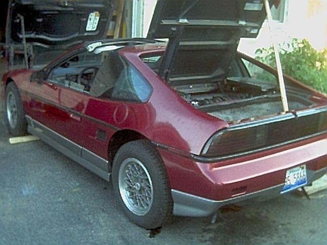

no, that isn't the point...that car is Bad A$$, but the car isn't a vette....kinda like it when people badge a car a "type R" and it isn't a type R.....kinda ricey to misadvertise, but to each their own, nice machine
Well it's a Corvette engine, so there is no reason why he should take them off. Plus it looks like ass without them. He has a corvette engine, so why isnt it allowed to say "Corvette" on the engine? Plus i dont think hed be fooling anybody into thinking the whole car is a Corvette

I totally understand what you are saying, and agree to a point. It is probably more for the layman then a true car enthusiast. Who would know regardless the engine does not belong in there. I have told friends I am putting an LS1 in and some say LS what ??? But you say same engine as the 97 vette they say oh! I do not plan on putting any corvette badges on the out side or anything. I have some McCahn (not sure of the spelling on that) style side scoops I will be putting on this winter. I want to have 5.7 LS1 V8 put on them in small gold print.
I would love to see someone put in an LS6. It would fit just the same. I have a few LS6 parts on mine MAF/IAT and one Exhaust manifold. Wish I had the cam, intake and heads to go with them LOL. I watch ebay every now and then you see the parts. If I ever found them at the right price I would pick them up. Except for the cam... There are better ones. But for now I am just going to enjoy it.

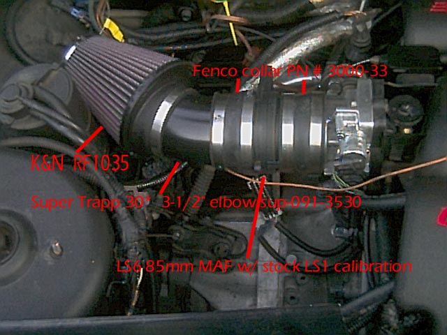

A little more info... I finalized my air cleaner set up. Complete with part numbers. The super trapp number is out of summit, but it is usually derived from the manufactures part number. And the part number for the Pace MAF/IAT is PAC8411F. I had looked for an anodized intake elbow but did not have much luck. Most are sold in kits which I didn't need. Summit kind of soaked me for the elbow $37 with shipping, but I had to have it. The K&N was $65 and the pace unit was $159 it works well. Here is also a pic of the whole car. I think the LS1 sits lower than the 2.8 did. On a sour note I ran over a can of primer backing out of the garage tonight. Splattered the entire under side

Congrats! That is AWESOME!!!
Leave the Vette covers on. Most people when they look at an engine swap don't know what they are looking at. That removes ALL doubt!
I've had a LS1 SS without covers, and now I have a Z06 with covers, and the covers clean up the motor ALOT.
Good luck with it! You need to AutoTap it to find out how the jetting is doing, and then get LS1Edit, and adjust fuel and gearing.
That baby is going to FLY!!! Typical stock LS1 engine pushes 310 hp to the TIRES. About 350-360 to the crank. You should hit bigger than that.
