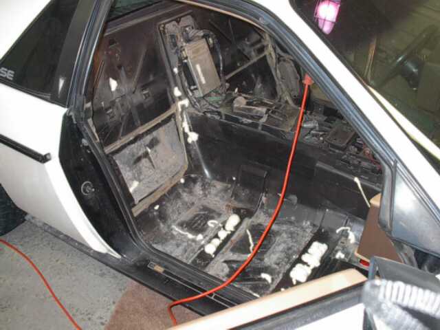

First job, remove the seats, center console, carpet and side trim pieces.
Then I determined where I needed to cut the firewall by tapping on it and listening for the hollow parts. It may be necessary to cut a small hole in the center big enough to feel around in there and then cut some more.
As you can see, on the driver's side, you HAVE TO BE CAREFUL! The gasoline inlet tube runs from the filler spout, down through the firewall behind the driver's seat. DO NOT CUT INTO IT! (just had to warn for safety reasons)
The passenger side is a little easier, but the space you can cut out is also a little smaller. I used a dremel tool with cut-off wheels to cut through the thin sheet metal.
After the holes are cut, I began masking off the driver's side in order to mold the recessed part of the box.
Here you can see the fiberglass already laid into the recess in the firewall. I put two layers of glass in there just to make sure it is getting sealed and to add more strength.

This is what the recessed part looked like after I pulled it from the firewall to let it cure.
That is all I have done so far. As I struggle with this project and a full time job, I will bring you updates as often as I can. Hope this helps somebody!

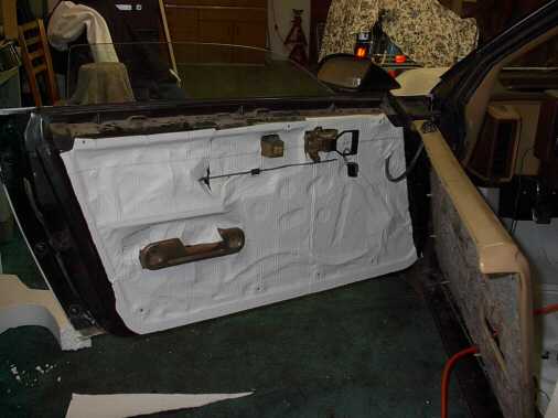

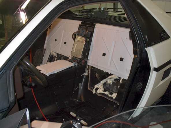

Here's one of many pics of mine. I use a 10" sub that only needed .6cf of space. That way you don't have to make the "Box" so big. I only used 1/2 the space & can put my amps above the sub. I only took up about 3" of leg room. The subs still handle 300W RMS & 600W peak. Email me or PM for pics if you want. You will like it when your done, your doing a great job.... Keep us posted! Chris.

i got some pointers. glassing the recess in is a good idea. i got my subs last fall to try this but haven't taken the time to work on it yet.

Now that's a great Idea!!! LOL! I used a material called Peel-N-Seal. It's used for repairs on roofs. You just cut the size you want & peel off the backing & use a 1" wood or rubber roller, then roll over it to stick it to the metal. It's about 1/8" thick. It also helps in road noise. I sealed it with silicone. Works great. https://www.fiero.nl/forum/Forum1/HTML/019876.html

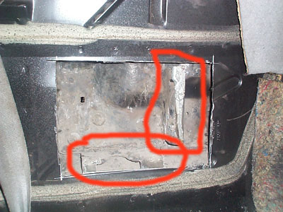

This is the hole in the passenger side, it has a couple pieces of metal sticking out. I take it i'm suppose to take these out also.

I left those pieces in on my passenger side for support. It is nice strong steel so I figured it was there for a reason. IF it is possible to fit the sub in with those brackets there, I would. The magnet for my sub fit perfectly right between them.

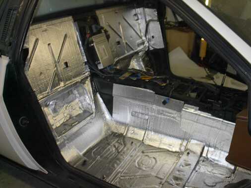

I'd just like to butt in here for a moment to say that clear silicone is not the best thing to use for sealant. The fumes from the silicone will eat away at the glue holding the surround to the cone. I use Liquid Nails for my enclosures as it is not silicone based and still holds really well.

Wheels1 - it looks like you cut that whole bracket out of there, did you, have you had any structure problems with your car?

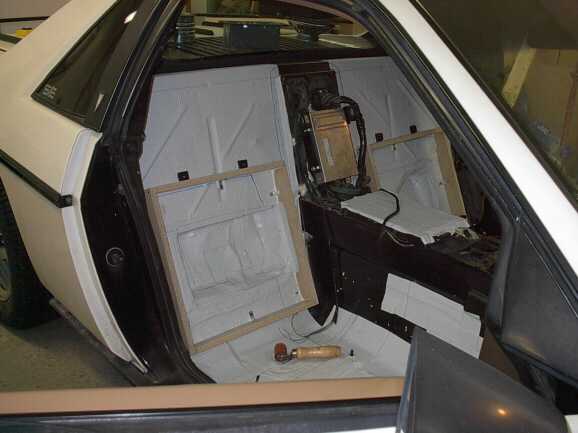

Okay guys, here is an update on the job. I am starting to feel overwhelmed with all the work I have ahead of me. I have a full poly bushing set, a rear sway bar, Intrax lowering springs, KYB shocks and struts, and my Stage 2 kit arrived today!!! USPS wouldn't leave it without a sig, so I have to pick it up at the Post Office tomorrow!!! I am SOOO excited!!!
OK, now for the update:
I installed the side trim piece and the center console back in the car so I can get an exact figure of the space I have available. I then covered the entire area with masking tape. I used 1.5" or even 2" masking tape.
Then I used the fiberglass matting and resin to form the shell, making sure I glassed in the recess I previously made. The rolls of paper you see were used to hold the fiberglass away from the vent for the computer and the other vent on the door side (I have no idea what that vent is for).
This is what it looked like after I pulled it from the car. I still need to plug up some holes that didn't quite get sealed right. Then I will build up the sides to add strength and enable me to start the front. Not a quick job I might add!

Report this Post07-20-2002 11:37 PM Click Here to See the Profile for Wheels1Click Here to visit Wheels1's HomePageSend a Private Message to Wheels1Direct Link to This Post
I did cut the lower brace, I made 2 cuts in it & then pounded it down flat. I need the extra space for my magnets. I also used foam for all holes..here are some more pics of mine. Sorry for the late reply. Been busy working on my 88 Formula....If you need pics or any questions please email me. c1irsik1@swbell.net Thanks, Chris.
88 Formula
WTB White 88 Formula t-tops w/5spd, pw,pl,cc,a/c,tan int.
[This message has been edited by Wheels1 (edited 10-26-2002).]

Wheels1
Posts: 945
From: Hutchinson, Ks. USA
Registered: May 2002
Report this Post07-23-2002 11:46 PM Click Here to See the Profile for Wheels1Click Here to visit Wheels1's HomePageSend a Private Message to Wheels1Direct Link to This Post
I used a material called Peel-N-Seal. It's made for repairing roofs. It cost about $.08 squ. foot. It comes in many sizes. I got a roll 36" wide & 33.5ft. Cost about $80. & I have enough to do the doors & apply 2 layers to the floor. It has a adhesive backing so you can use a 2" roller to apply it to the metal. Works Great!..
88 Formula

Wheels1
Posts: 945
Report this Post07-24-2002 03:45 PM Click Here to See the Profile for Wheels1Click Here to visit Wheels1's HomePageSend a Private Message to Wheels1Direct Link to This Post
Me Too!!! My dads shop...It was one of these "Look at what I found at the dump today" "It works great, but the shroud is bent, so just keep your fingers out of it".......Things...
88 Formula
