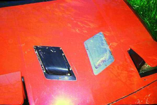

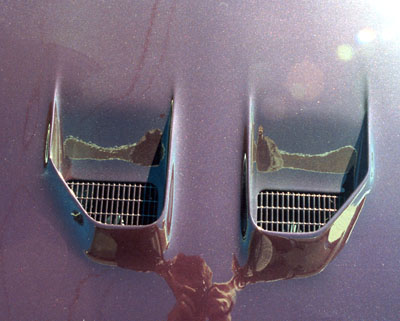

sorry for the size...
i'm trying to collect new pics i can crop down when i get camera time.
these are from an '81 z28.

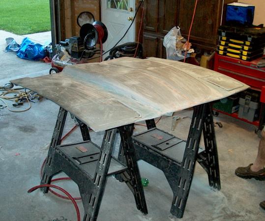

I am working on a custom hood vent. It is not painted yet, but I will post pics when I get home from work...
Here it is... unfinished, but you get the idea:

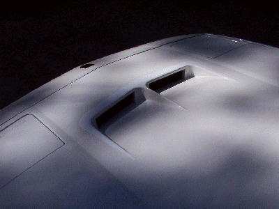

JL Extractor Hood Vent from Rockcrawl... not currently in production, but he is keeping track of those interested.

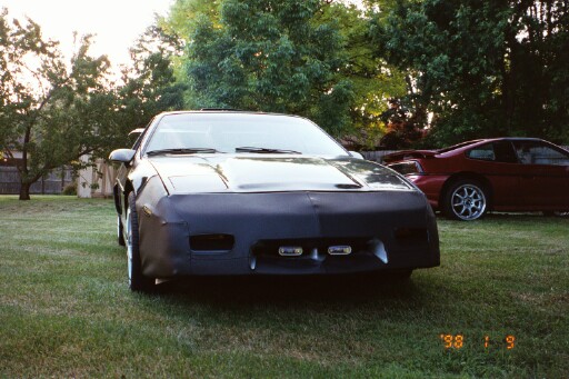

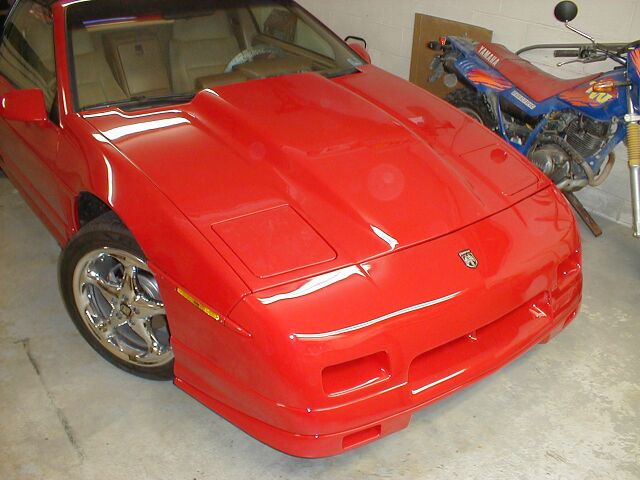

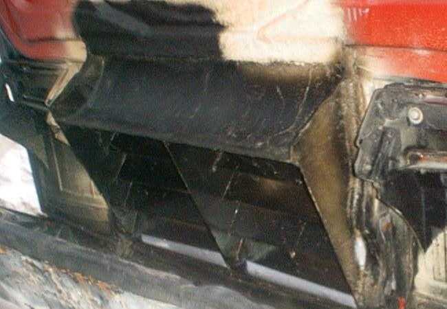

Here is a fully funtional extration hood I created. It was created from a ZR2 scoop which I felt was too wide and killed the lines of the Fiero. I cut over 4 inches off the width and created a center line that works with the center line of the nose. The original ZR2 scoop does not work with the Fiero lines by killing the side lines and it has a dip in the center but the Fiero has a ridge in the center. It is amazing how much heat comes out from the hood especially when the fan is on.

skitime: I like the cut-down functional ZR2 vent. (the full size version looks dumb on a rear (mid) engine car)
Philphine: Those Camaro extractors are very similar in size to the TA extractors I mentioned.

Hey, Ski, gotta question. Have you done any aerodynamic tests on your hood at speed? I know the old cowl induction style hoods brought air IN, not let it out, because of the high pressure area at the base of the windshield when the car's at speed. I'd be interested to see if you're getting much venting, or if you may be actually defeating the purpose by having the opening that far back.
It obviously works well at slow speeds or in traffic, because the fan provides all the pressure, but at highway speeds the aerodynamic pressure may overpower the fan or the airflow from the radiator inlet.
Just curious. I'd be tempted to tape some streamers around the hood outlet and see what they do on the highway.
Yes I did do the streamer test on the hood. The results were a slight intake while driving until the fan came on and then it was very strong exhaust coming out the hood. Since I have a custom chip in my ECM the cooling fan comes on at 180 degrees so in nearly always on. The fan is actually pointing up at the hood so it really creates a stong wind out the hood which can easily be felt even at the top of the windshild.

Why am I not surprised. Good work. Apparently the cowl induction affect isn't as much as GM would have led us to believe. What else is new?

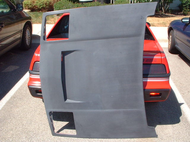

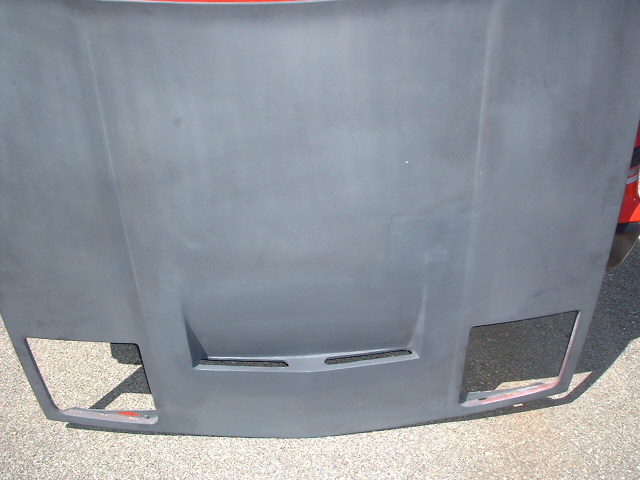

Heres the Warber style hood I sold last week.
(not yet finished)

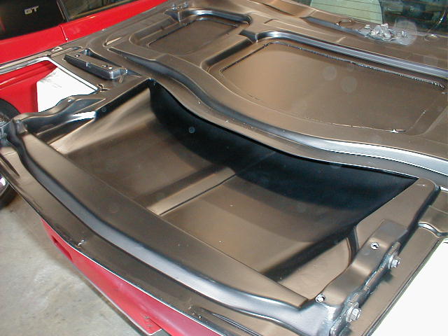

Puts her hands together for a job well done.
Both inside and out.
Now how many people would of just stopped at the outside, but not Ski...
Kudos to you

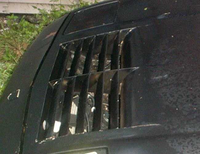

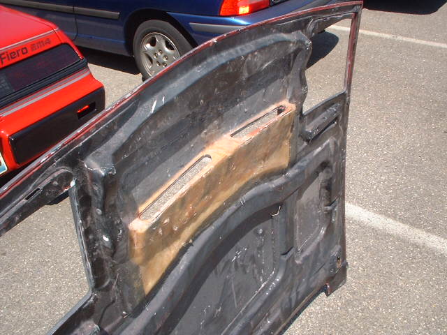

found the camera. this is the hood of the chop top i got from fierodave...
i didn't make this one so i don't know how to reconstruct it. if there's anything to venting the hood, this one ought to do it.
