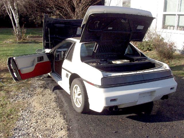

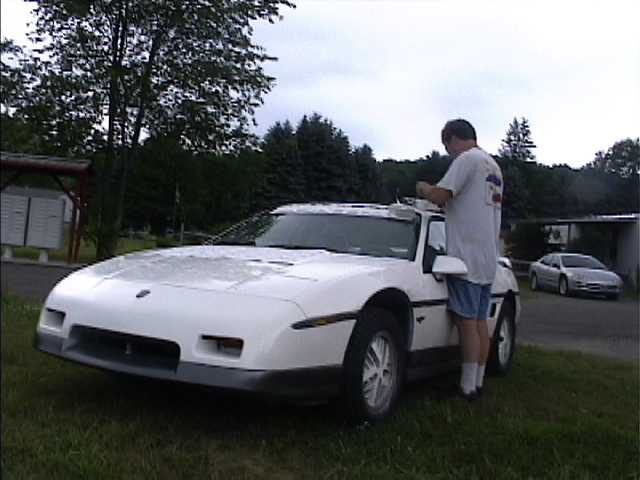

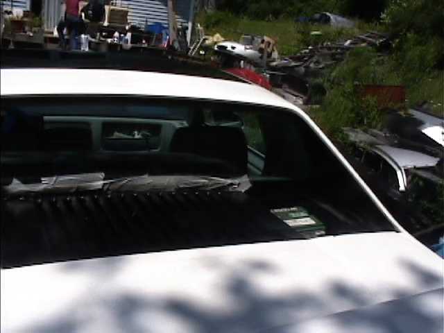

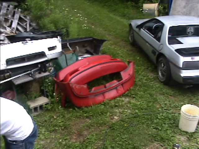

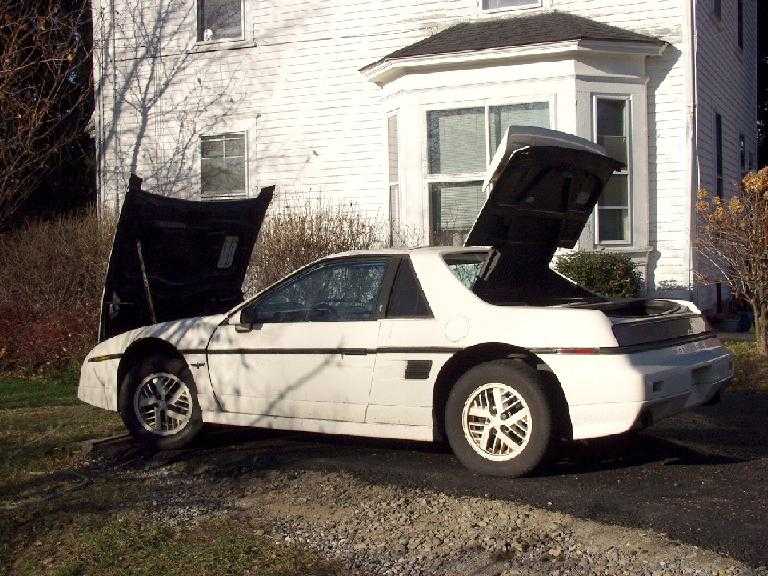

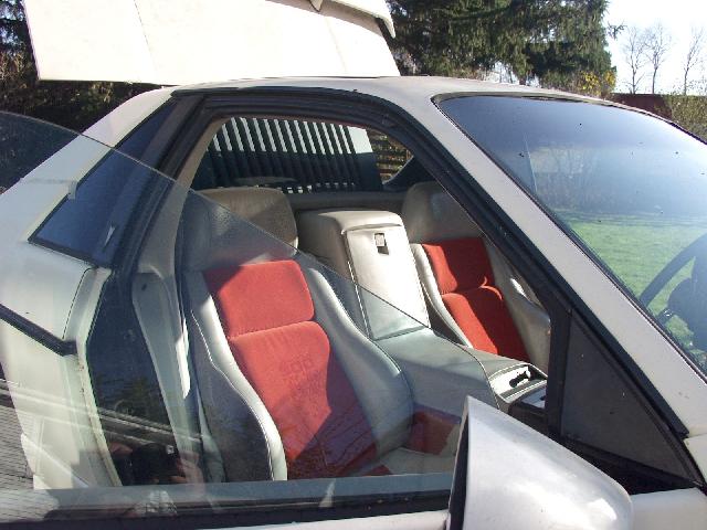

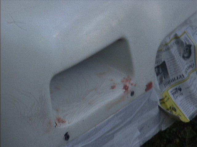

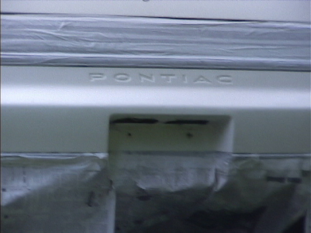

This Indy has come a long way as Chester and Elvira can attest to
Here is how it looked not long after Chester and Elvira picked it up late last year:
As you can see, a previous owner before Chester and Elvira had decided to repaint it. Unfortunately they did a bad job on the paint and even painted the ground effects. The paint was now badly chipped and cracked all over. BUT, it had potential.
As it was one of the rarer 4 speed Indy models (today less than 25 manual transaxle models are estimated to still exist) and it has the very rare 4:10 gears, this was an Indy needing some TLC. As Chester and Elvira had many irons in the fire allready, they were looking to move the Indy and the Wedgy (the Gold base model 86 with T-Tops).
After offering it to me, my Dad and I made arrangments to pick it up, promising that in return we would take real good care of it. The drive home was very eventfull, and I will save that story for another time.
[This message has been edited by Fiero5 (edited 07-26-2002).]

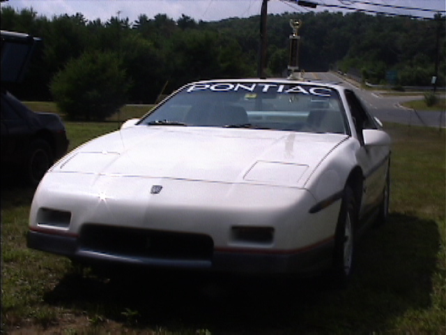

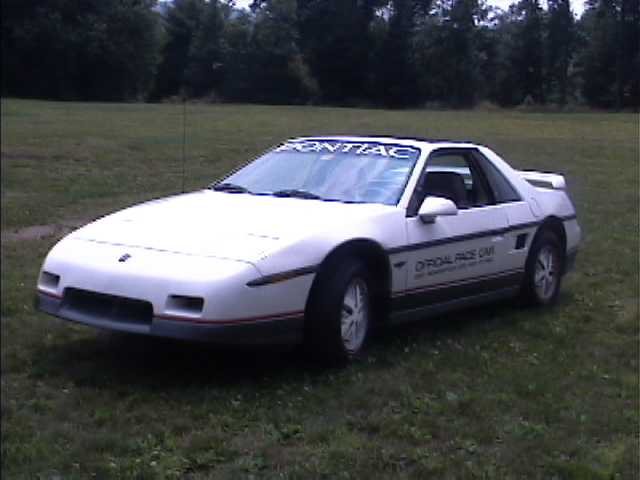

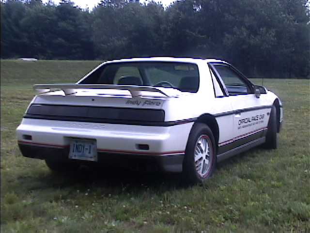

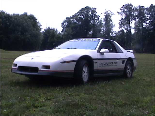

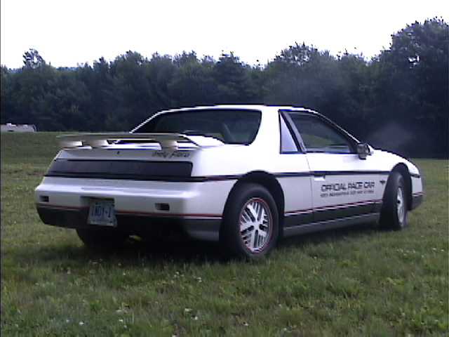

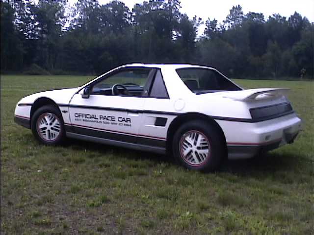

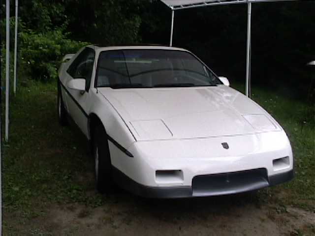

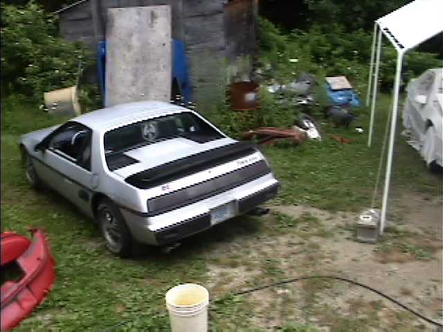

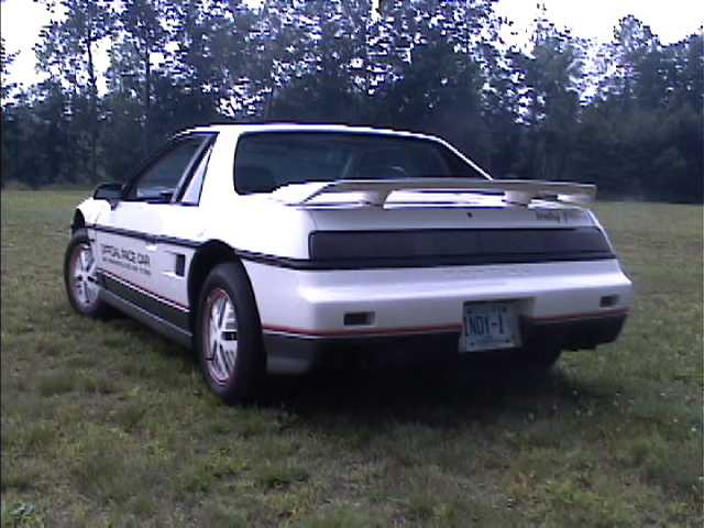

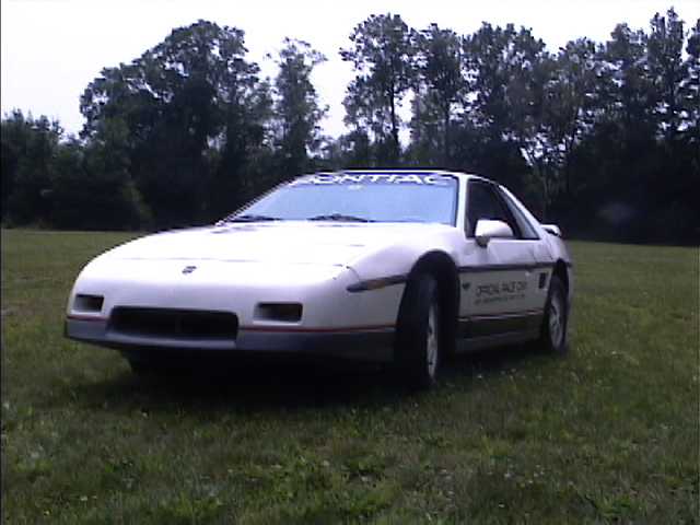

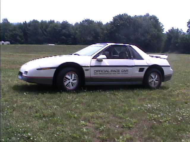

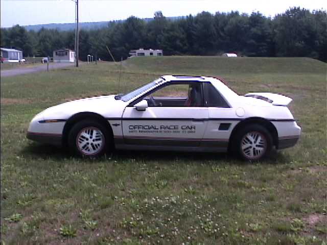

Lietterally the night before the "FINE '02" show in Sturbridge we were adding the finishing touches to this sweet car. I will show some in process and during sanding and painting pics soon.
Here are some after pics:

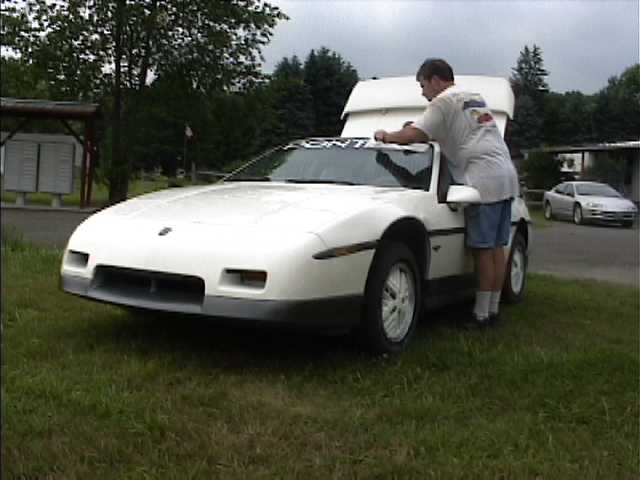

Here is my son Jordan who rode with me in the Indy:
The Indy sure drew a crowd all day:

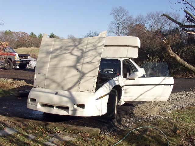

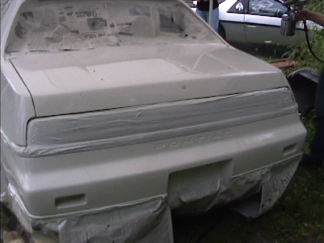

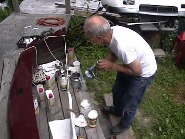

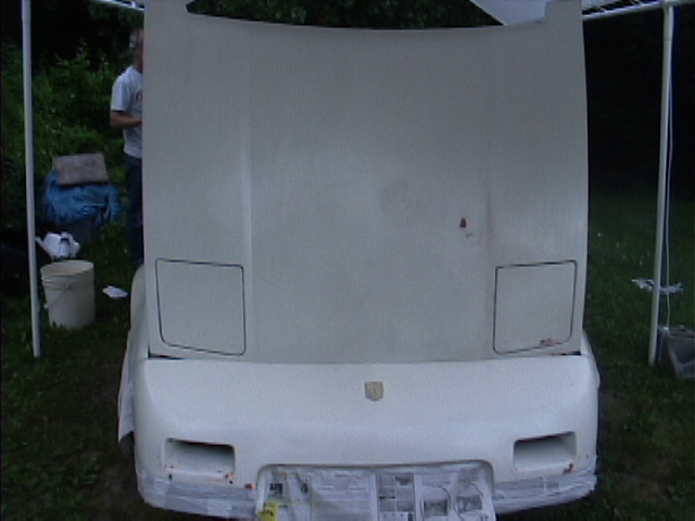

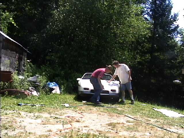

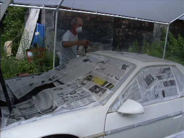

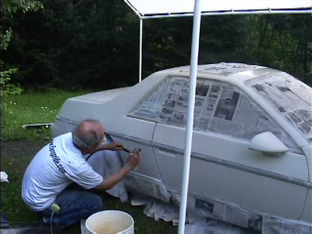

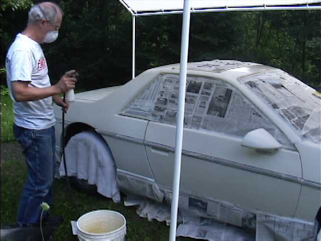

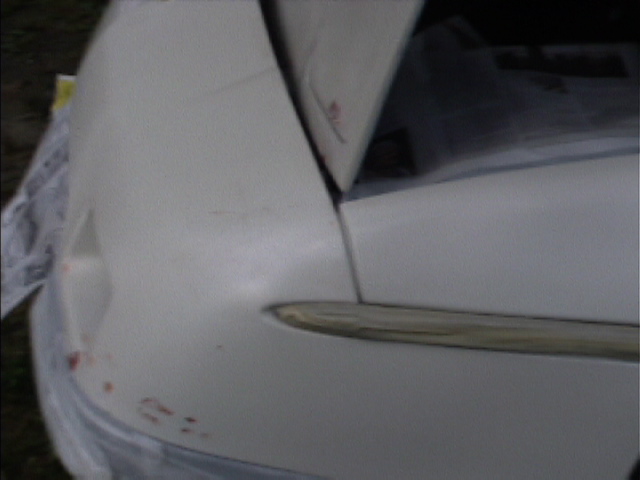

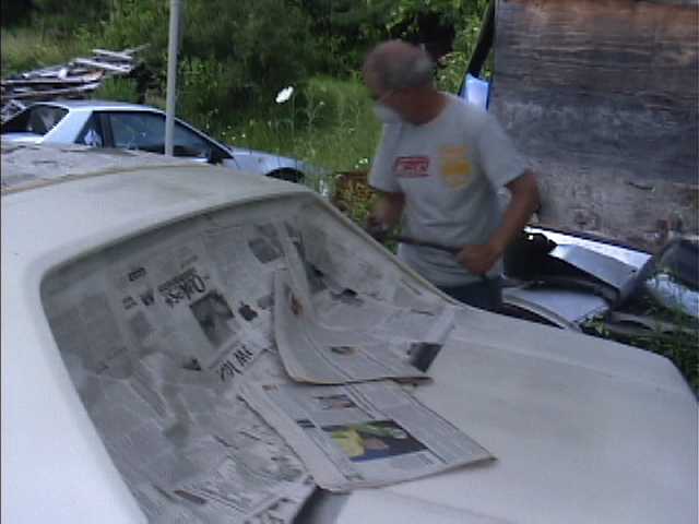

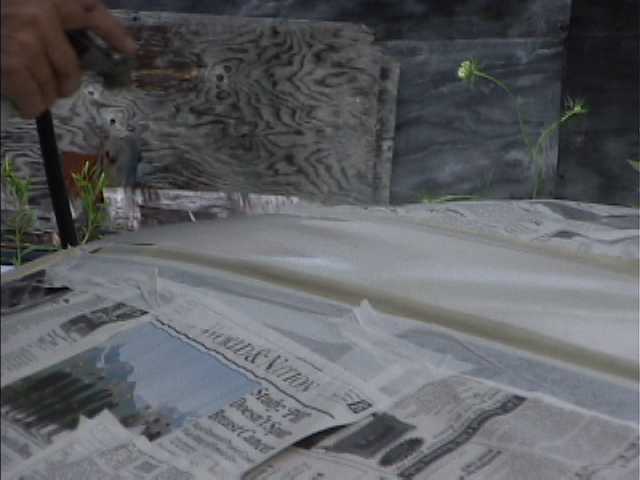

OK, here are some progression pics of the Indy being prepped and ready for paint:
My temp plate-

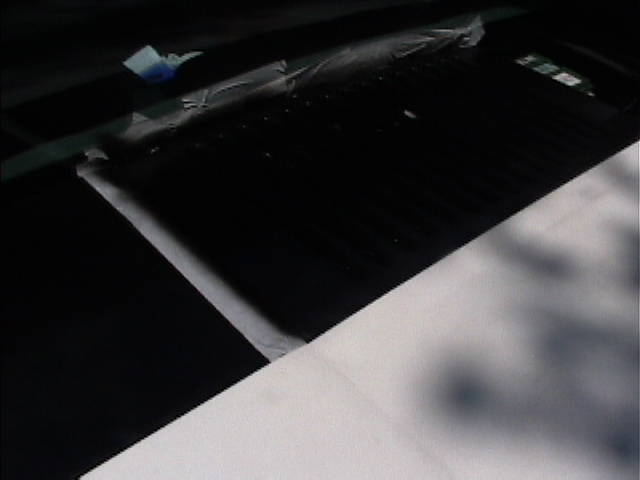

Black painted onto the vents and covers-
My Dad and I going over last minute areas to get them ready for the paint gun-
Now the car is completely masked-
The last areas to get touched up-

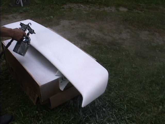

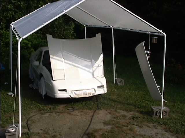

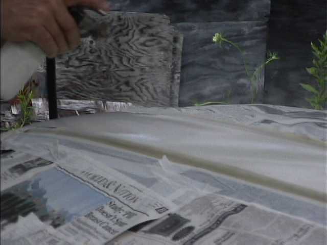

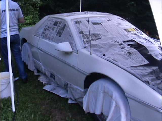

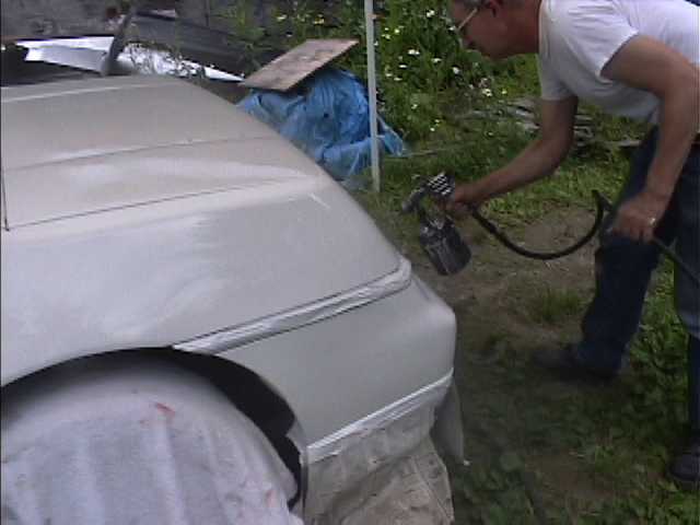

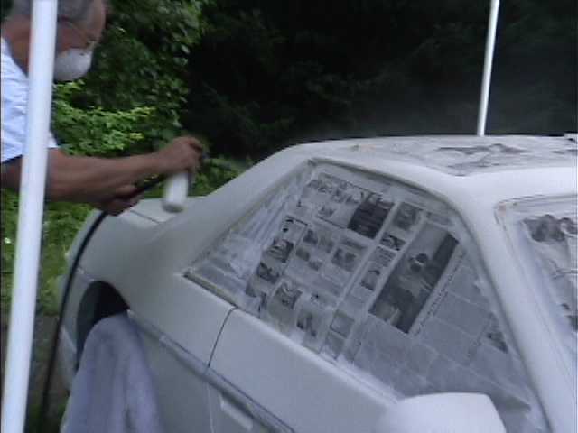

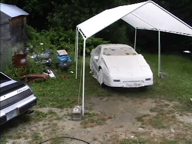

Now the code 40 white paint spraying begins:

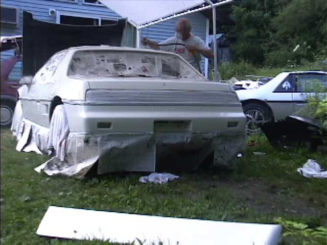

As you can see we have lots of Fiero projects going on

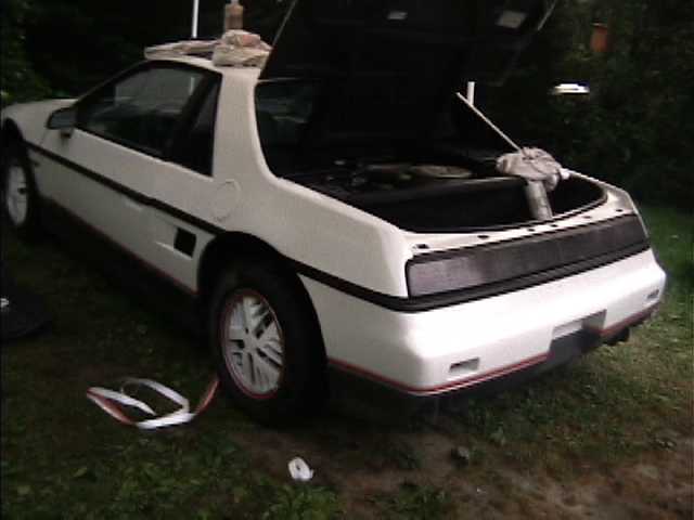

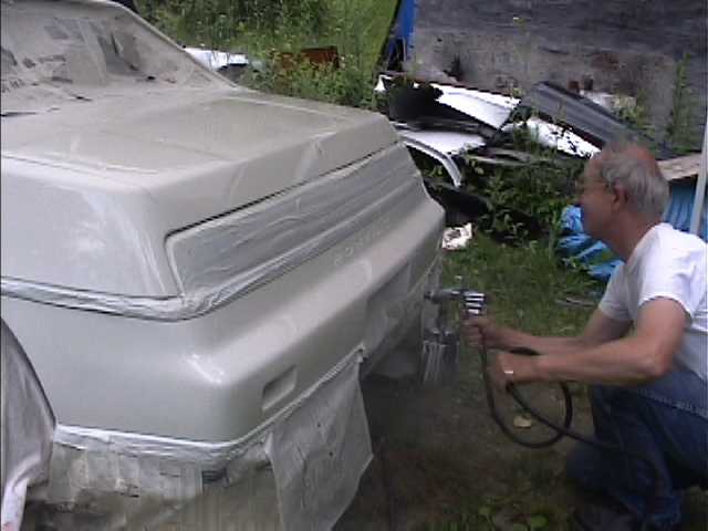

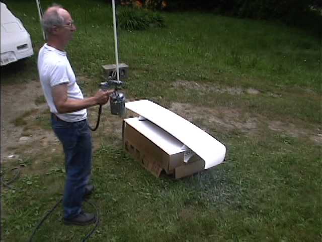

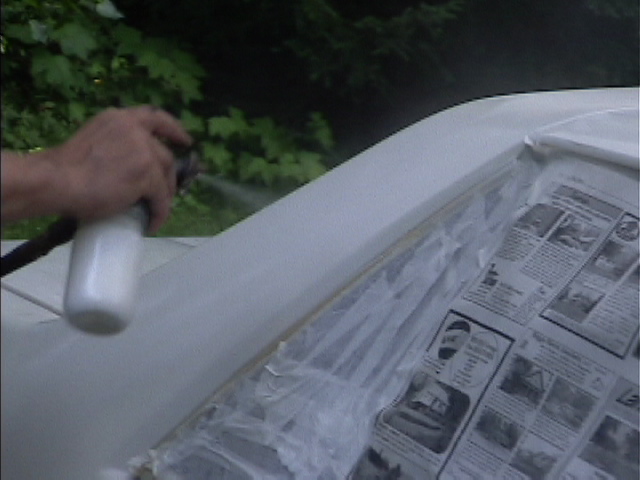

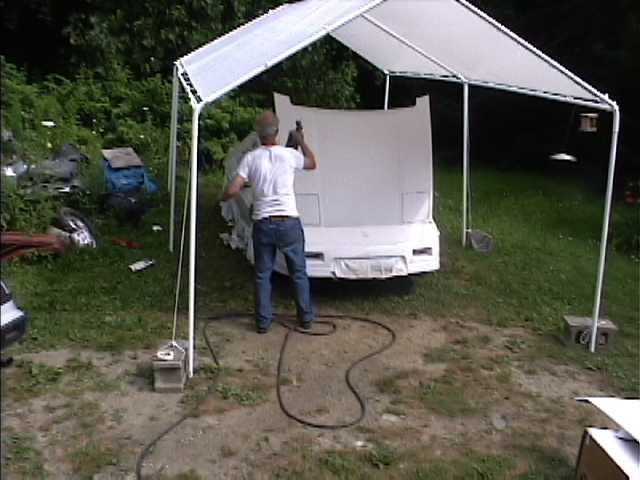

More painting:
The clear coat is now applied:
Now the clear on the car-

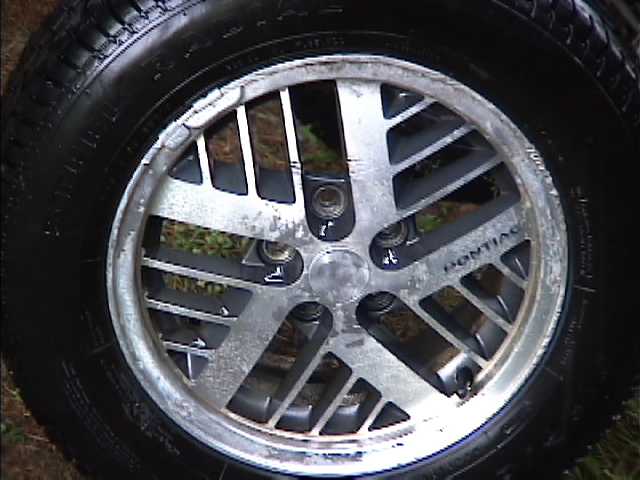

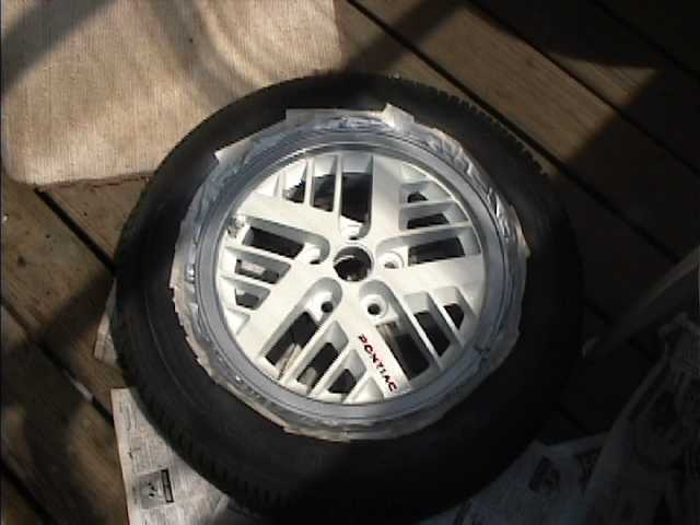

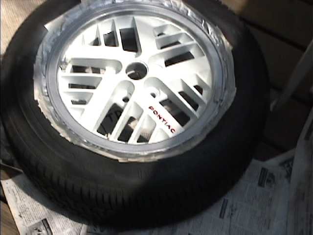

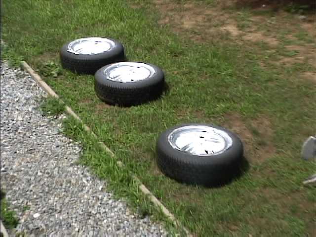

Now, while it sat for 48 hours to dry,

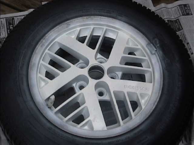

I worked on making a better set of rims then the crappy ones that were on it after adding new tread to them.
With new tires on them, these were the donor rims I used:
Fresh coat of white paint:

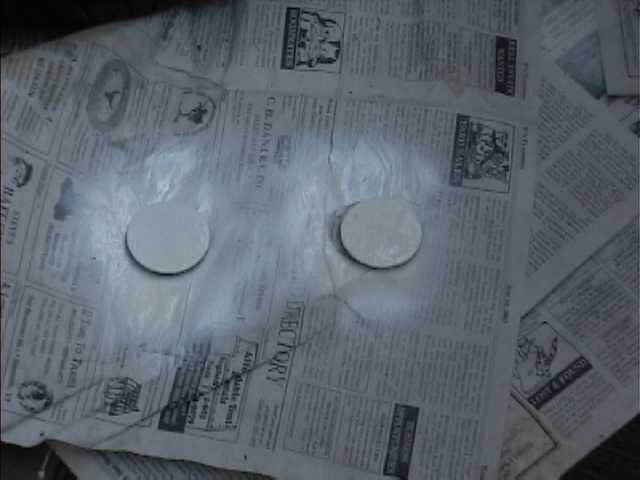

Painting the center caps:
After painting the rims, I took a power drill with a metal polishing brush and polished up the outside rim:
I also added the red paint to the Pontiac logo:
Here are the other three ready to mount:

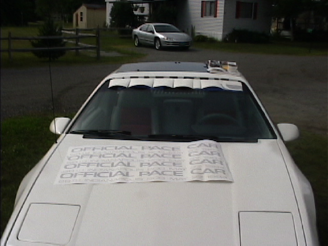

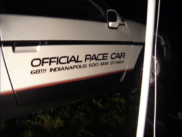

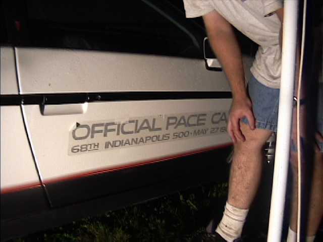

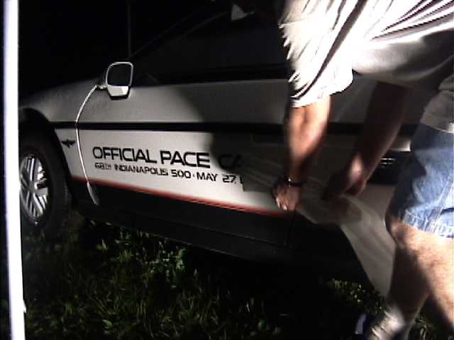

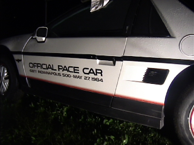

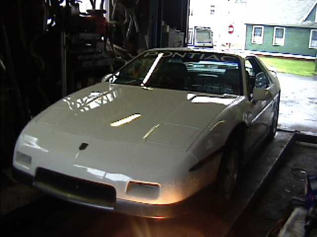

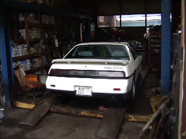

I had about an hour and half before going to my inspection appointment Friday afternoon, so I decided to add some of the decals. I alos swapped the rims and tires, as the old rims looked cruddy and the tires wouldn't have passed inspection.
After also applying the rear deck lid decal, I was off to the inspection station
After getting my inspection sticker, it was back home to finish getting the Indy ready for the show the next day.

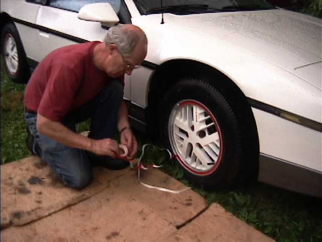

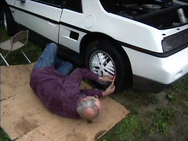

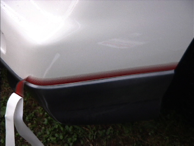

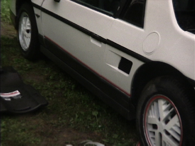

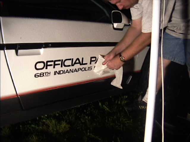

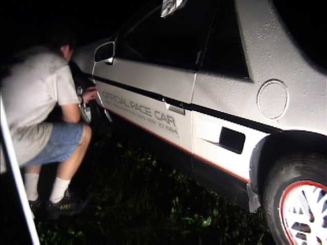

My Dad tackled the red wheel stripes while I applyed the red fader stripe:
As you can see, it is now getting very dark out:
Luckily my Dad had a nice bright utility light

you painted it out in your yard? happy with the results? i'd love some tutorial on that procedure.

I'm interested in the paint also, how did that work for you being outside and all, Everytime I have painted something outside, I've gotten bugs and dirt and everything else in the paint?

The painting outside was fine. That is what wet sanding and buffing is for
Murphy's painting law states that any part of the car that is still wet or even sticky, is the exact spot a bug will happen to decide to land
