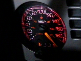

Report this Post06-24-2002 11:34 PM Click Here to See the Profile for Capt FieroClick Here to visit Capt Fiero's HomePageSend a Private Message to Capt FieroDirect Link to This Post
Capt Fiero
7657 posts
Member since Feb 2000
HEre is a pic of my stock speedo in Canada it is a factory 180 reading speedo. IN the coupes we have factory 140 reading speedos.
yeah but that 180 tranlates to 120mph and 140 to 85mph right?

Capt Fiero
Posts: 7657
Registered: Feb 2000
Total ratings: 260
Report this Post06-25-2002 01:02 AM Click Here to See the Profile for Capt FieroClick Here to visit Capt Fiero's HomePageSend a Private Message to Capt FieroDirect Link to This Post
Correct, but for you USA guys you could start buying up all the un-used canadian 140kph gauges that we toss around like your 85mph gauges and relacibrate it to MPH and have a factory looking 140mph speedo as a drop in. No face plats just re-crystal and plug it in, you might want to clean off the KPH marking in the middle though.
