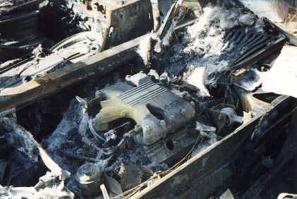

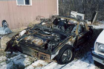

The thing about the exhaust flanging... not quite. Your exhaust gasses will not cause an engine fire. Many people drive beater cars (Fieros and non-Fieros alike) everyday with broken exhaust manifolds- and they don't catch fire. I'm pretty sure this is the 1st time I've heard this rendition!
The "Magnesuim Theory" I've heard before. But again, not correct (strange how the '84 recall didn't affect the Magnesium grill at all). Pure magnesuim is extremely flammable- once it's ignited. But the Center Decklid Grill on the 84's is actually made of a Magnesuim Alloy- meaning that other metals have been mixed in before the part was cast. An alloy acts with properties of all the elements used... therefore the Magnesuim alloy used has a higher ignition temperature, as well as a higher strength (pure magnesuim is not extremely hard). So again... a fun theory- but not it.
Most of the Fiero fires I've seen or heard of had nothing to do with the recalled issues, but rather "bad luck" or "driver/owner error". Like not parking your car with it't hot exhaust over anything likely to burn (this is something that you should think about in every car).
The above photos are 100% real, I shot them myself, in my side yard. The only salvagable parts of the car was the lower trim on the passenger side- which is now installed on my GreenGT!
