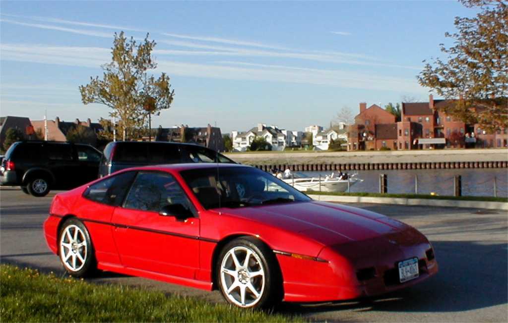

I just thought I would post some pics of my completed stereo install, plus a nice pic of my GT that I took earlier today.

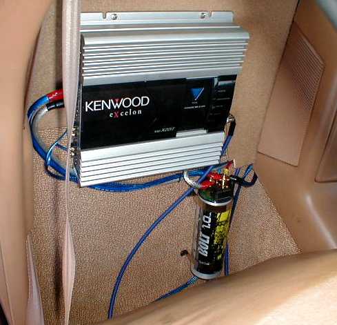

The amp and the capacitor behind the passenger side:

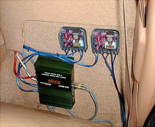

The other amp and the crossovers behind the driver side seat:
And this is what it's all in:

-Boss AVA-2001R 100x2 ($50-from a friend) This amp will be replaced soon

Lightning Audio Bolt Series 1-Farad Capacitor ($82-ebay)

Looks pretty good. I run a stereo shop in MN. Just a suggestion, there is a bracket inside the dash with a hole in it. The back of the factory radio has an alignment pin that goes in it for robot assembly I guess. This bracket does no good for any aftermarket radios, and if you remove it (hammer,saw,whatever) You can use a flush/resessed mounting kit that looks great and doesn't stick out 2 inches. It's also easier to get to the buttons. This is the way almost all GM cars are. The reason it has to stick out with that bracket still there is because the factory radio is not as deep as the aftermarket or "DIN" size. Good luck, and like you said, definately get rid of that boss amp.

It would be nice though if you give some attention to make a nice finish to the amps and accesoiries.....but thats just me

For a neater install appearance you should try to run your cables under the carpeting. Just make some small slits in the carpeting and run the wire thru them. It would make your installation look more proffessional an neat.

Thanks for the input.
I really don't mind the wires hanging out that much. You can't see it when the seats are back, so I didn't bother to do much about it except to zip-tie alot of wires together.
I would like to build something to make it look a little more professional, but I have an engine project to worry about now. And all the stereo stuff will be coming out next year so I can Dynmat Extreme the entire interior, so I will probably do it then.
